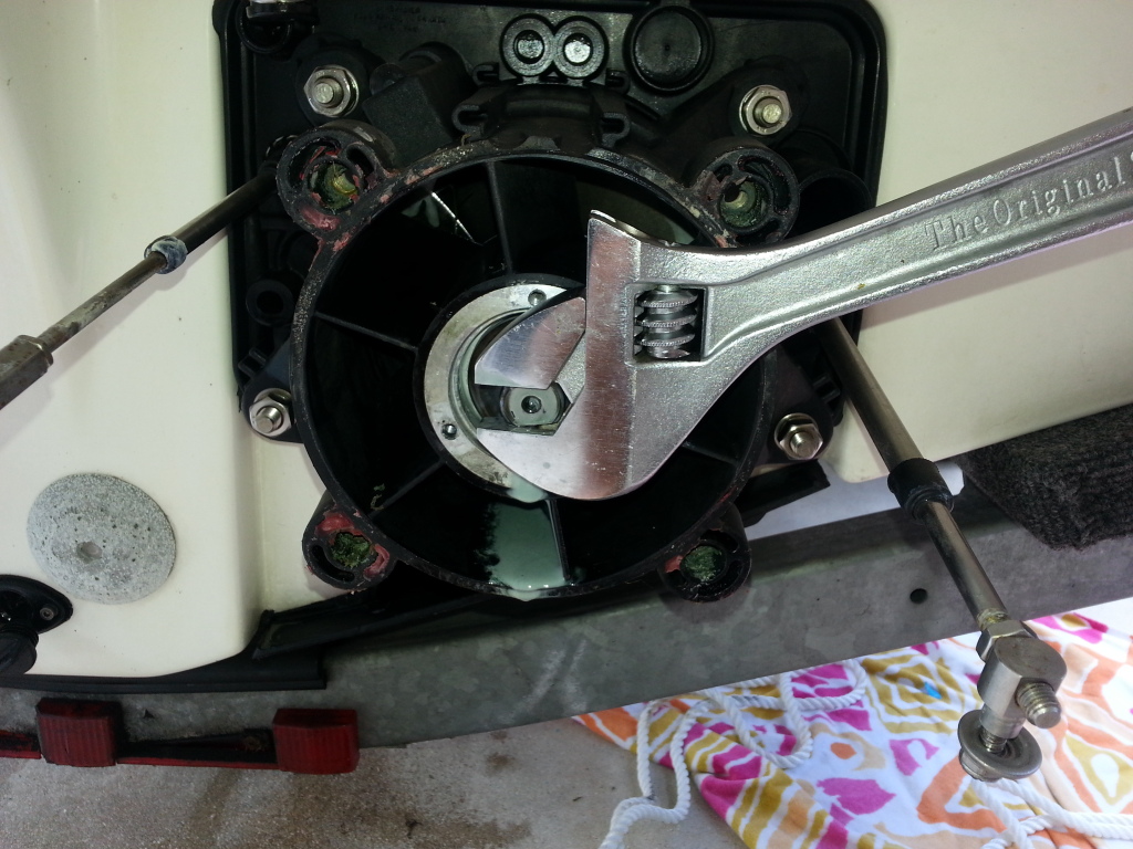

I ended up pulling the spark plugs and fogging the cylinders, then took off the nozzles and dropped the jet drive cones off the back so I could put a wrench on the driveshaft. I reversed the rotation and was able to back the stuck line right off.

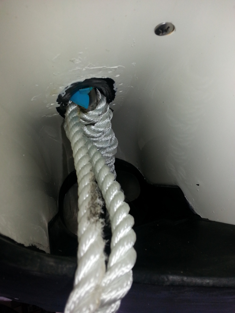

Only 1 problem. I noticed some blue plastic after I removed the ropes, it came off the drive shaft and appears to be coming out from the engine / hull down the shaft.
I sat in the water for 2 hours after my mistake, when I pulled the boat and opened up the drain plug, zero water drained out so if these were seals they are still in tact further up.
Do I need to replace these plastic parts asap? I cleared the shafts, I then fired up the engines and flushed them out (since I could not do that until the shafts were clear) and everything seemed to function perfectly. Just not sure if I need to tear it down and replace these parts right away.

The Rope, you can see the blue plastic I am referring to here.
Removal method:
Removal method:
