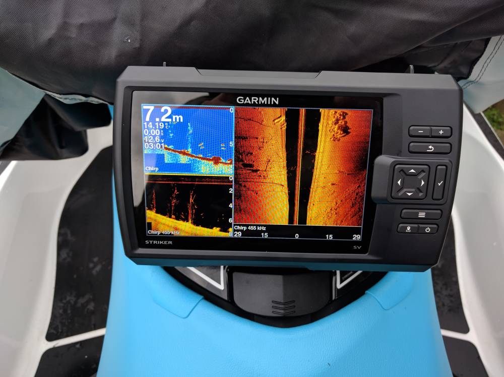

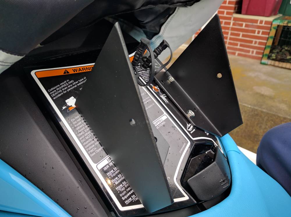

I recently completed the installation of my raymarine pro 4 gps/fishfinder with DVI. I fabricated a mount bracket out of aluminum (primed/painted) and mounted it between the ski and step bar. I ran the cable underneath the seat. I purchased a suction ram mount (short) and it holds extremely well on the glove box lid. When not in use, I store the cable (zip tied) in the hull (2007 Sea Doo GTI SE 130).

Shacho, How is the pro4 working out for you? I've been looking at one for a couple of days, after reading a lot of material. The IP6 and IP7 ratings are what makes the unit stand out for me. I don't know enough about the electronics on them to know what's hype and what's great.
The screen seems a bit small, but if it's mounted on the glove box lid (as you did) I think I'll be able to see it well enough.

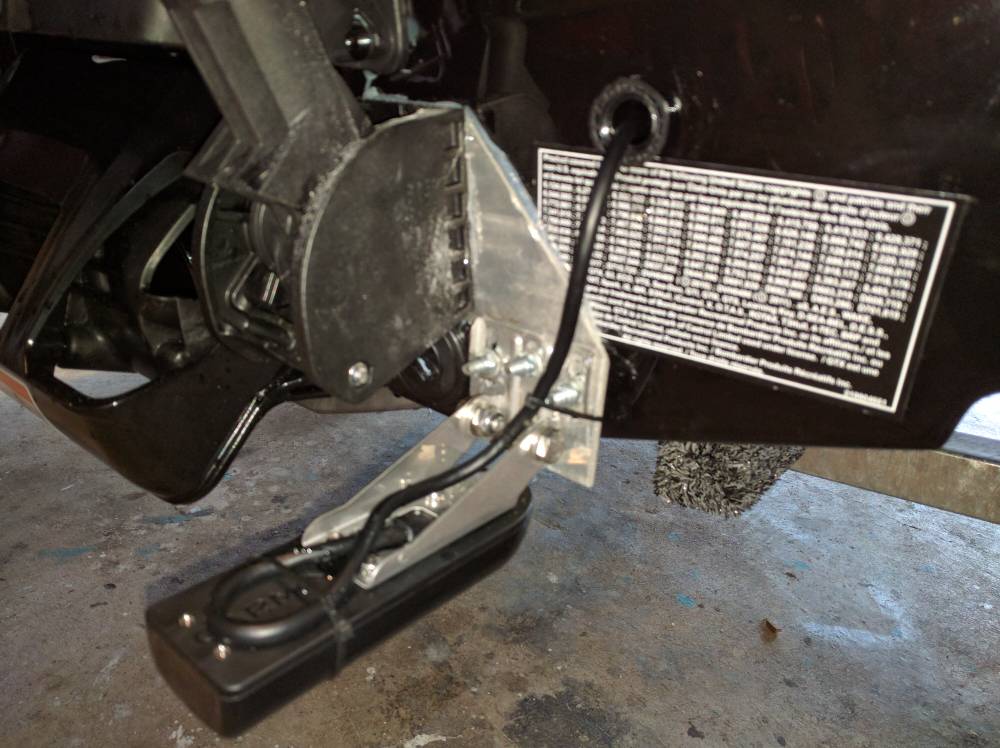

What concerns me the most is the transducer mounted on the transom. Have you had any problems with that? Did you mount it at the bottom of the transom or a bit higher? Drill or glue?
You mentioned running the wire under the seat. At first I just thought that was from the transducer, but I'm wondering, did you also run it from under the seat to the unit on the glove box?
Anything you'd like to share about the unit or the installation, I'm all ears.

Here's how I installed my fish finder. The hardest part was finding someone to bend the aluminum just right. Also, I put some clear sealant (rubbish like after drying) on the bolts mounting the transducer to the ski.

Thanks Shacho. Those pics help a lot. That transducer looks huge. The 09 GTI has a small round spot on the inner hull to mount a thru hull transducer, I assume, port side just out from the centerline. But the transducer for the Dragonfly 4 pro appears much longer (x2 or 3?) that the round spot.
When I asked Raymarine about thru hull transducers, their answer was that they had heard some success stories with epoxying the unit into some single layer fiberglass hulls. When I asked them of their opinion on the transducer taking the beating on the back of a jet ski, they suggested I go to jet ski forums for others experiences.
You've said it works up to about 25 mph, if I remember correctly before there's too much interference. I can work with that I think.
