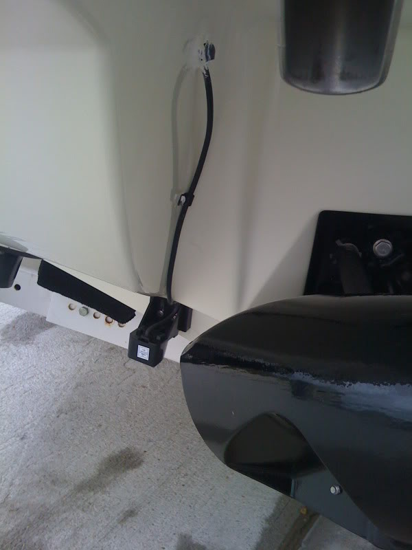

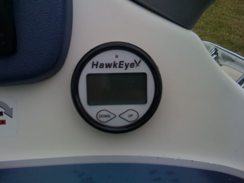

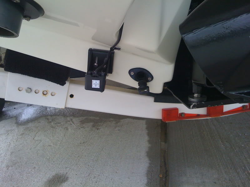

I too bought the same depth finder you have but got spooked about drilling a 2 inch hole in the bottom of my boat after talking to friends and reading post on here. I sent it back for the outside transducer. So far its works awesome and it wasn't hard to install just follow the instruction. I wanted the water temp feature and I don't think the glue type offers that. If ya got it from eBay they will exchange it for ya just call them and let them know you want to exchange it. Here are some pics of mine :cheers:
