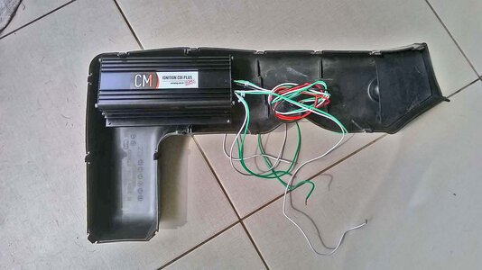

Because of my CDi ignition, when I used coils with bad insulation, spark leaks would occur, and this would cause the ECU to lose the code and cause central locking. To avoid any more problems, I removed the code!
My CDi plasma ignition is inside the air intake! To refresh better and prevent contact with water!
