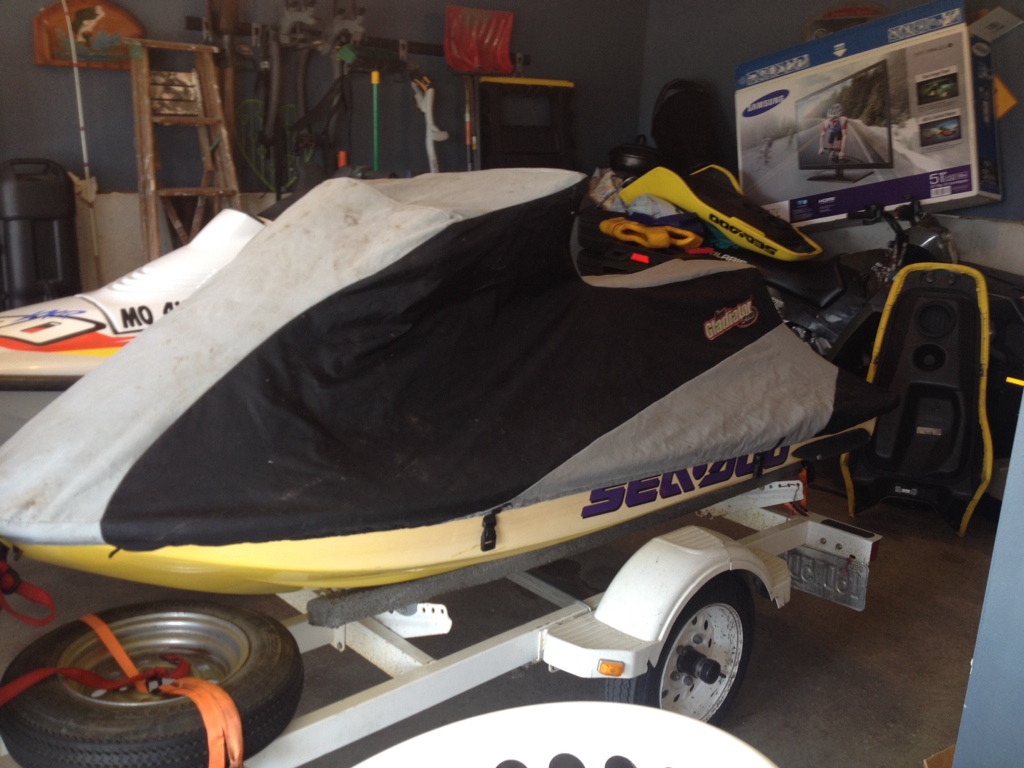

On the other hand just picked up this 97 spx today. It was for sale for with a trailer, but I didn't want the trailer so I paid him 550 for it, and even got a test run! Def needs a good clean up, all the maintenance done, fuel lines, carb clean, raves, etc. this thing is 17 years old and the raves have never been removed, engine has never been opened either. 150 psi on both cylinders. Hell even the VTS works and I get the double beep. It has had a new mpem at one point, and although it didn't run spectacular, it did feel solid. Had a new wear ring last year, and the guy even always used seadoo full synthetic. It will be a work, I can't decide if I should keep it, part it and have a spare engine and parts, or fix it up and sell it. Gauges are all water logged and faded unfortunately

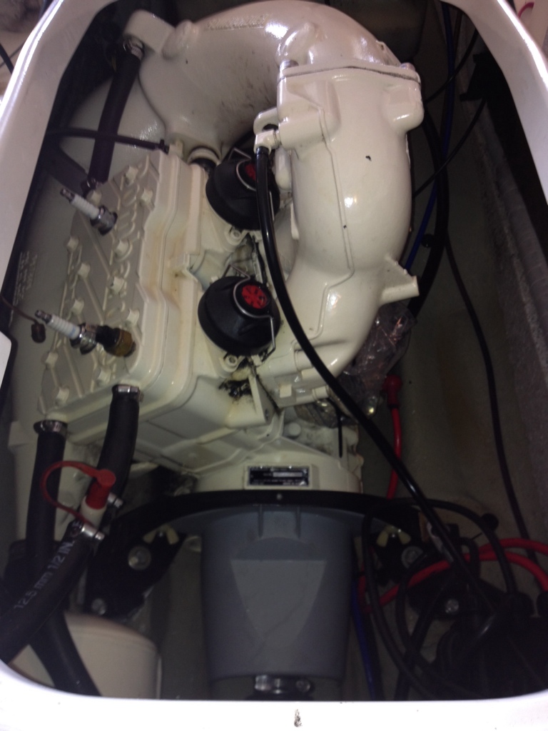

Well, spent a good long day on this thing. Will spend tomorrow after work cleaning up the outside and making it like new. Detailed the inside as much as I could, super clean and a scrub brush, a shop vac and some water. That's all I did. I wish I woulda taken before pics, it was filthy as any other 17 year old ski is.

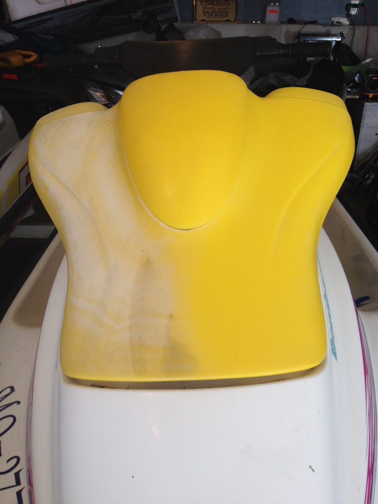

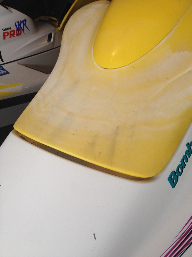

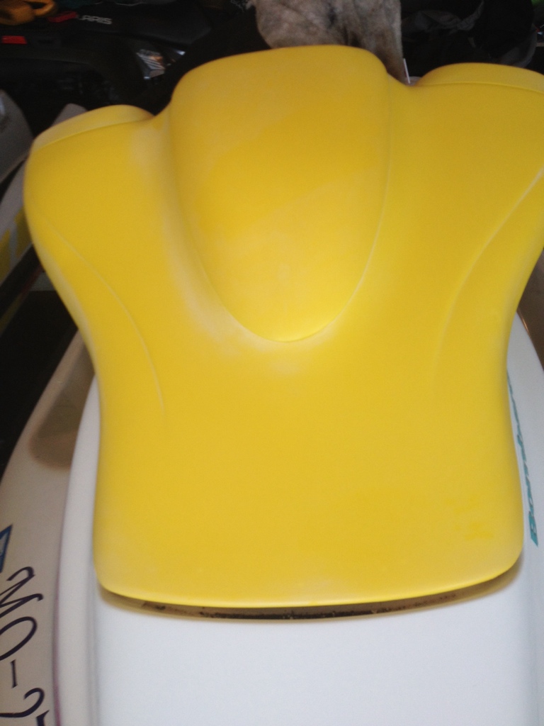

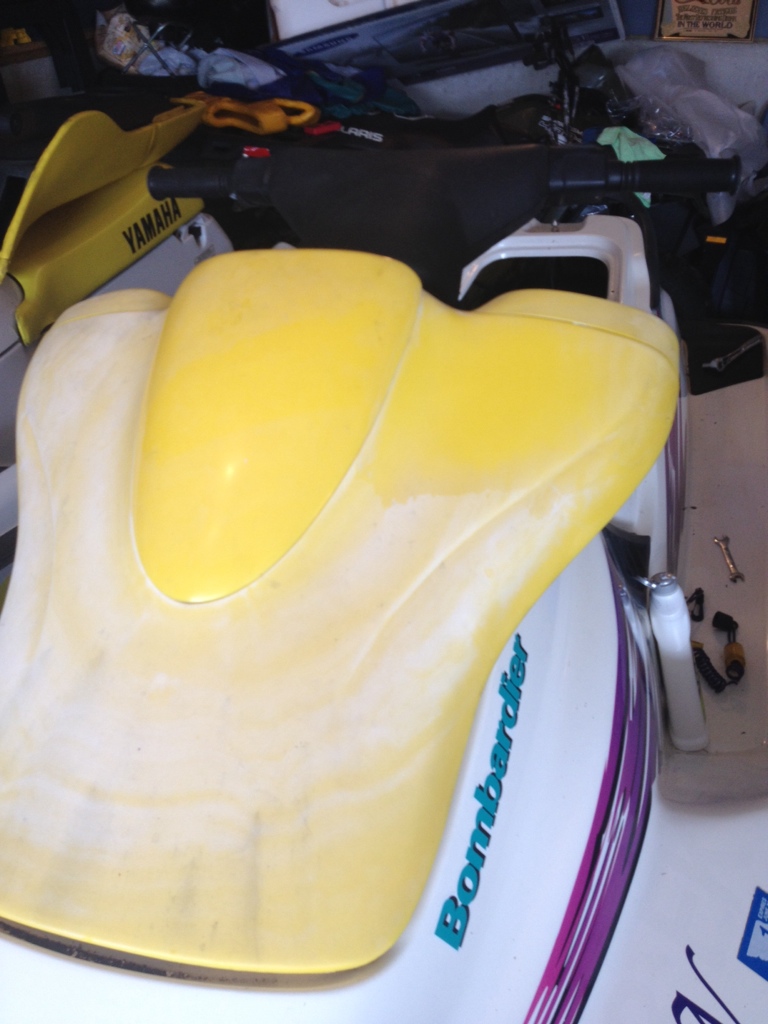

Next, well before that I had to do something about the sun faded hood. Did the old "softscrub and a scotchbrite", still needs a little more work, but this is only after about 20 minutes. Will be like new tomorrow.
You can see where I still need to hit it a little harder tomorrow, where it is still white. So much better tho.

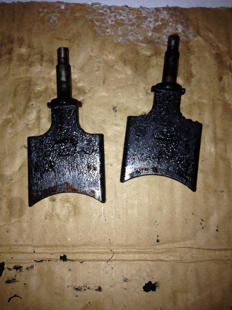

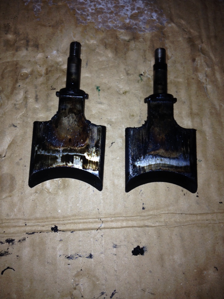

One thing I loved about this was how original it was. The raves had NEVER been removed as you can see, I was expecting to see a mess like never before when I pulled them.
But this is what I found unbelievable, when I pulled them they weren't actually too bad, especially not for never being serviced!
A little clean up and they are good as new, I threw some o rings on there but reused the OEM gaskets because they still didn't leak and they had the paint on them which I loved. Replaced all the fuel lines, cleaned the carbs and fuel selector (which I will replace because the ON just never seemed to flow very well.

Also replaced the oil lines with yellow tygon and it should be good to go. I love the fact that nothing has ever been touched on this thing, makes it easier to work on. And love the fact the previous owner used XPS2 so I don't even have to drain it, just keep adding. Probably why the engine is in such good of shape and the raves were so clean.

So you just used scotchbrite pads and softscrub on the hood and it came out like that?
Yup. Softscrub and scotchbrite. I did a small section on the hull and it took away some of the fading as well, think I am going to try it on the whole thing. And then buff it

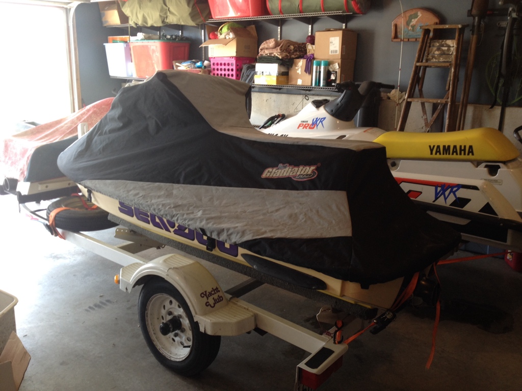

What's going on with the laundry basket with the ratchet strap through it?
K if I told you, you might understand being from Texas. Maybe even BNelson, probably not racer since he's a Northeast city boy.
The strap is on there because it is the trash can for the beer cans and I strap it on the back of my 4 wheeler when we are all out riding at the farm! Hahaha. Im not going to litter, ya know??? Ha
