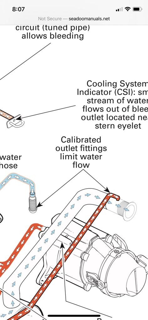

He's referring to the hose connection at the hull plate, that's not a calibrated fitting. It's perfectly fine to leave a quick connect hose adapter on as long as it's not the type that would block flow when not connected.
