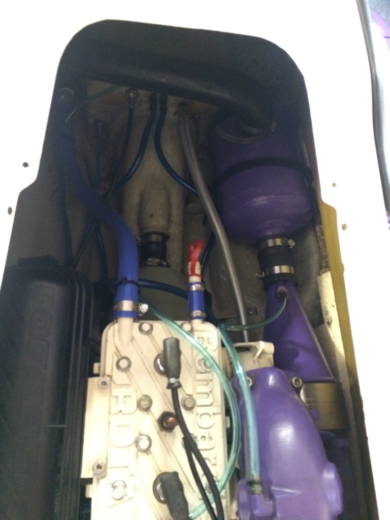

Ok so this is were I have questions I didn't feel like pulling the pump and I'm not sure I did the right thing but I just put a bead around the very small area that the water was weeping on the pump I also put a bead around the inside of the bailer tubes were they come out inside the hull. Next I put back the bailer tubes to the stock positioning I had shortened the tubes to just come out straight to the bailers not knowing that they needed the L fittings that hold them up under the grab bar area stupid I know but after reading that they needed to be stock like this I made it right could having the bailers like this actually dump water in the hull along with they other leaking issues? Here is a pick of how I had them you can see the blue tubes going out straight to the bailers

Having the bailers low like that they could back feed. If you look at the elbows they have a small pin hole in the side to help with the vacuum effect.
Yep that's what I read thanks for the clarification. Would you have pulled the pump and re rv'ed it? I'm really second guessing my easy fix of beading rv around the leaking area of the pump.
Short cuts are not worth the headaches, sorry.

Ok thanks Racer not what I wanted to hear lol! I'll pull it and do it right. I did have a good amount on and it did squish out but not like your pics. I did have issues trying to get the drive shaft to fit the pto so Mabey jollsling the pump around so much moved the rv out of position.
Good catch on that photo! +2 that the tubing for the bailers needs to be corrected with the correct elbow fittings and raised to to the correct position.
