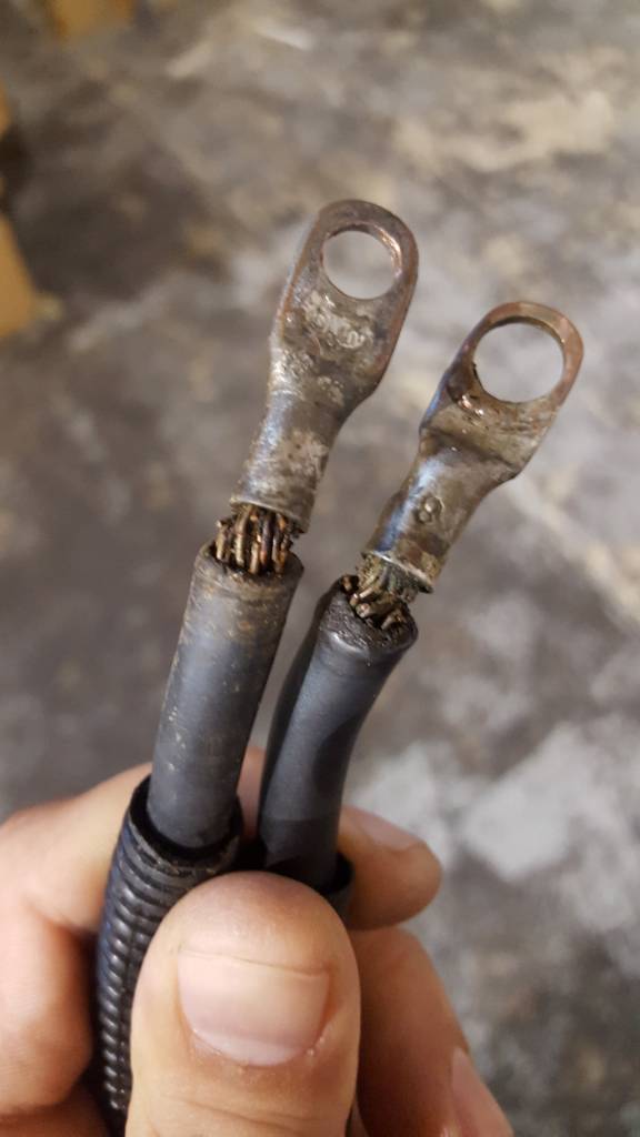

Pulled the ground wire off and when i pulled back the sleeves i think i found my problem. The ends look like hell

Well a new ground cable didn't fix the issue, still wont turn over. It is better if I just loosen the spark plugs a couple turns it will crank, and removing 1 plug it cranks fine which it wasn't doing before. The #'s now are disturbing though:
