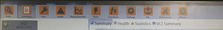

K Keithp New Member Aug 19, 2021 #1 Does the ECM store a history of engine temps in a ‘21 GTX? If so, where would one find it in the ECM Software? TIA Attachments 2C81D270-46E7-45EB-ACB9-90940D695AC3.jpeg 67.1 KB · Views: 3
P pretex Member Aug 19, 2021 #2 You need a BUDS or CandooPro to get access to the runtime logs that show that and a lot more.
K Keithp New Member Aug 19, 2021 #3 pretex said: You need a BUDS or CandooPro to get access to the runtime logs that show that and a lot more. Click to expand... By chance, Do you know the selection flow in BUDS to bring up that log in particular?
P pretex Member Aug 20, 2021 #4 Nope, don't have a BUDS, I have the CandooPro. On Candoo they have tabs for the different option that you can view like runtime history, last 60 seconds, settings, etc.
