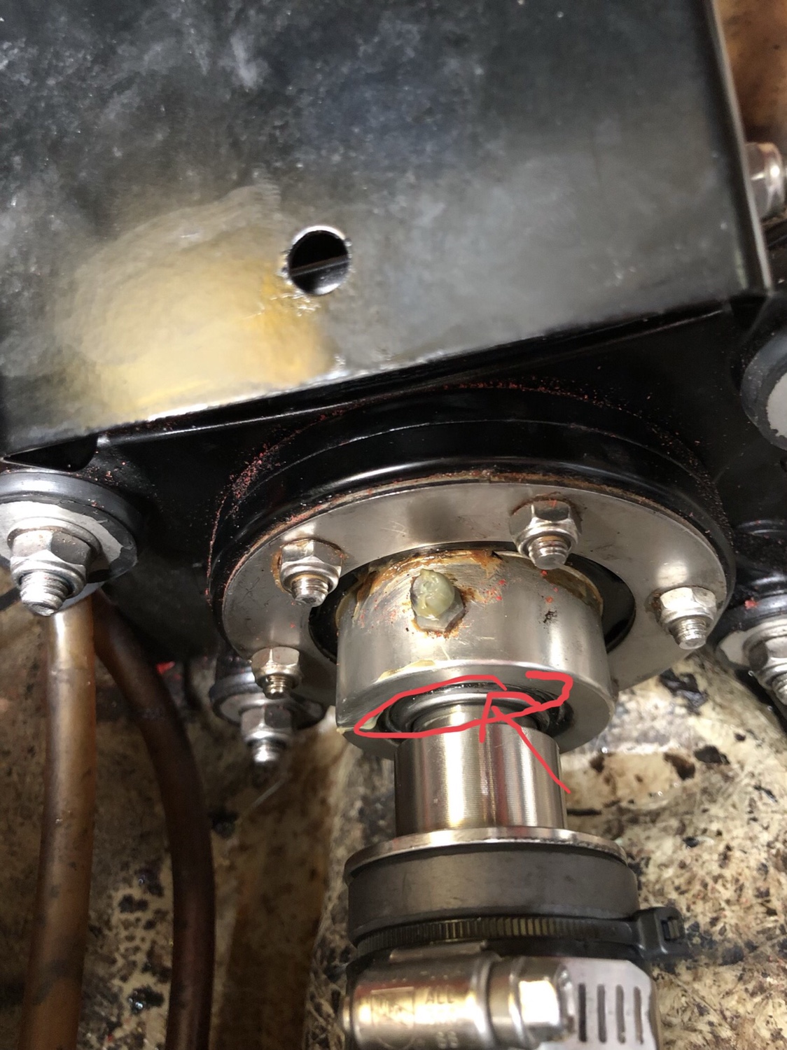

Should this lip be spinning with the shaft or sitting still?
The only thing that should be spinning is the shaft itself.
