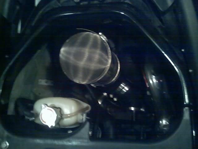

untill you get the RPMs you want,I am almost done with my air intake and it is
second to none true out side air, been taking pics along the way, front and back air intakes are about the same size witch means --with the vacume inside the hull it is pulling about the same air flow from both ports all based on pressure witch means your sucking very warm air much warmer then out side, black pain job its cooking in there, Any intercooler can only cool so much, an intercooler pulling out side air can only cool to lake temp. paint job will look much like 2011 RXP-X , from the bumpers up will be new
some decales and a different seat a bit more red.

That is the trade off. If i flip my ski the chance of water ingestion is very real. 4" up front is a very good and safe improvement over stock......but you see better performance from a rear air intake. Cooler air...shorter path to the sc.

I reinstalled mine wate to you see this, Clear 4" line so I can see the air pass through!!!!!!!!!

I reinstalled mine wate to you see this, Clear 4" line so I can see the air pass through??????????
Most just zip tie the rectifier to their new intake or do like I did and leave that section alone. That way the bungies around the gas tank stay tight.
re your "clear" 4" intake hose. I hope it's strong enough to handle the suction that your sc is going to be applying to it when you are at wot.
I bought it at a wood working store, its a vac hose for saw dust
good for a lot more then my SC can put out

Heh...beware that 4" clear dust hose on your ski. Your supercharger moves a lot more air than a vacuum cleaner. If that hose collapses.....you won't be happy.
