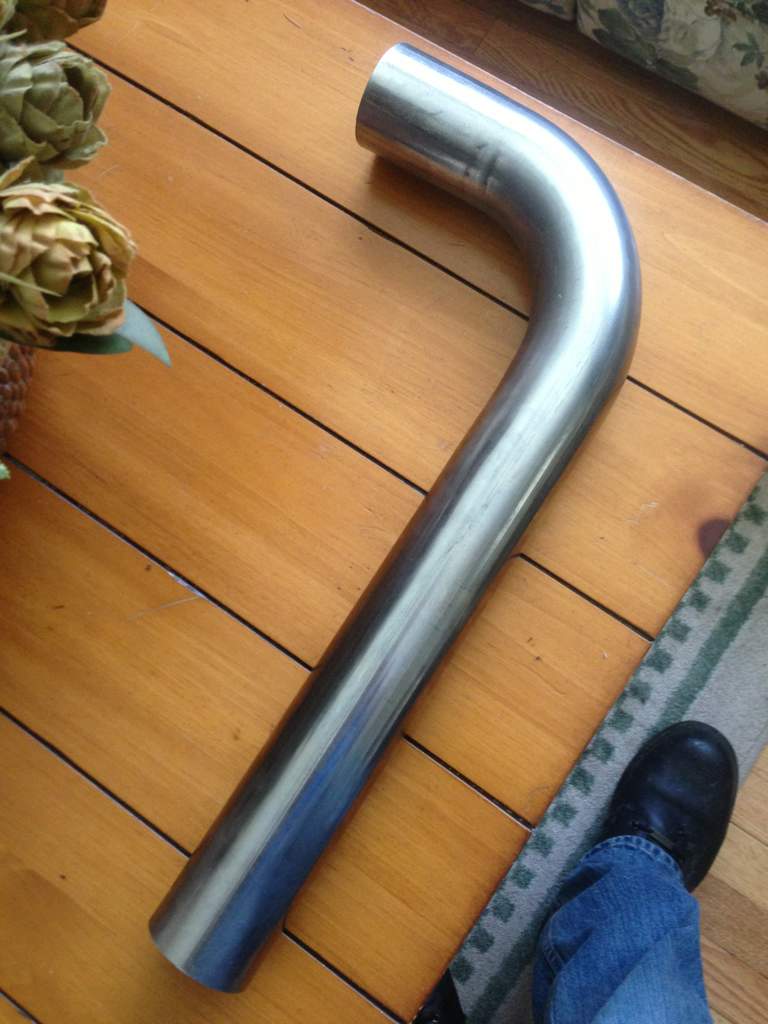

just ordered my stainless steel pipe for mine... cost 30 bucks with my ebay bucks certificate... now all i need is my ski haha
Boom baby!! This came today... Now all I need is a jet ski :( haha
The sc adapter will be here tomorrow and once I get it back ill throw everything in.. Thanks again!
BWAHAHAHAHAHA!....holy perspective Batman!...thought the slats of the table were the hardwood flooring....it looked huge next to your foot....HA!
lol.....that's that new 8.5" exhaust piping...coming soon to PWCMuscle.com lol...
