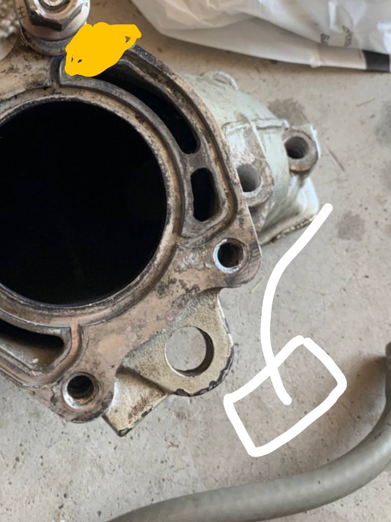

2001 seadoo gtx 951 carb. Broke this small piece off when removing the monster exhaust pipe. Will this leak water? Is there any hope of salvaging the part? Please advise
Well, considering that the oval hole is part of the water jacket around the exhaust, it'll leak.
Obviously, the best course of action is to replace the part.
Me, i'd probably try to rebuild the edge with JB Weld epoxy and grind it smooth with a dremel....I've done silly stuff like that with success on other things but I've never had to do an exhaust part like this from a jet ski, so I can't attest to any level of success you might have if you tried.
Just out of curiousity...why were you taking the exhaust system apart? You threw the word "carb" in your original post and I said to myself..." self -> you don't need to remove the exhaust pipes to get to the carbs". Of course, makes more room, but taking the exhaust system apart is a real PITA from what I've read....have personally never done it myself though, never had to.
I put carb in there to differentiate between the carb and di model. I changed all grey fuel lines, drained and cleaned oil system, replace injection lines, and re built carb, got sick of working around the pipe so I yanked it
I surely would not JB weld that section because there isn't room to put enough material to make it as strong as it needs to be.. Still.... I don't think you have an issue if it is just that one broken piece I see. Where is the water going to go?

I'd be concerned that epoxy (jbweld) wouldn't stand up to the heat for long, however, if you want to try it to see how long it will last, here's what I'd do...
... fill that whole corner so that you're creating a plug that covers the entire broken area, versus trying to rebuild just the walls. Yes, you're losing a little cooling capacity but not enough to matter, I believe. The JB will have much more surface area to adhere to.
I'd cut a little plastic piece off a milk jug and tie some dental floss through a hole in it. Use that as a backing for your JB so you don't fill the pipe chamber. Bend it in to where you are making the plug then pull it tight to the bottom surface with the dental floss and tie it off. The jb won't stick to plastic so when you're done you grab the plastic with some pliers and pull it out. The floss will stay embedded in the repair, who cares.
Then file down there repair area so it's flat.
Hard to describe and I don't know if I'd bother versus replacing the pipe, but here's a toddler's description in picture.
Yellow is the entire area I'd JB after creating and inserting and tying off the plastic and floss dam as shown in white ( you put the dam under where you're repairing before you start to keep the cavity from getting filled).

All good points...however.....I did not mean to imply straight KBWeld epoxy. JBWeld makes a malleable epoxy steel compound that you can mold into shapes...so taking a little piece of the product and rebuilding that little chip MIGHT work (after some careful grinding, etc...).
That is an exhaust part for sure so it'll be subject to heat, BUT the chip is on the outboard side of the water jacket so it shouldn't be getting THAT hot if the water is flowing through the jackets.
Where might the water go IF he did nothing....maybe nowhere if we assume the gasket gets squashed into the cavities when it is re-assembled.....but water does have a way of getting into places where you don't really want it.....probably nothing to overly worry about as any small amount of water would then be exhausted out the pipe ( mini internal steam cleaner????? - but again, with a water cooled jacket how HOT would that area ever really be getting???? (I don't know)
This will only work if you have a JBWelding certificate. I think they're available on-line? :)
BTW, my bet is if you assemble with new o-ring, (jb weld optional), it will be fine. Using new bolts/studs/locking nuts is required in this location but they must fit properly to avoid creating new issues.

I wouldn't JB weld on the exhaust. Those parts can't be that expensive can they??

That’s again for all the info guys this is my first jet ski and my first time taking one apart. I ordered a used manifold off eBay for $80 so I don’t have to worry about it. @sportster it is the o-ring style. What do you mean new nuts and bolts are required? The same ones can’t be used with some Loctite?

There have been a rash of broken bolts and studs due to vibration harmonics, recycled ones are also more prone to backing out. The official suggestion is to replace this hardware and torque to spec.
If you decide to and can find some shouldered studs, I personally prefer them to bolts whenever possible although some frown on changes.
New nylon insert locknuts and lock washers (where applicable) will help to keep things from backing out as well.
This location has been a sore spot for many and the associated bracketry for the pipe is muy-importante.
The o-ring design was a big improvement so dare I say, the famous leaking issues were resolved.
Good luck, I have high confidence whatever you decide works well.
