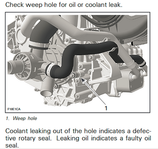

I have found forums saying it could be the oil cooler, the drive shaft leaking, or the oil filter.
I replaced the filter, no leaks or issues there... I'm leaning towards the oil cooler but that's a big job to do if its not the thing that is leaking.
Before I rip the machine apart... is there anywhere that you guys can think of that I should be checking for the leak?
