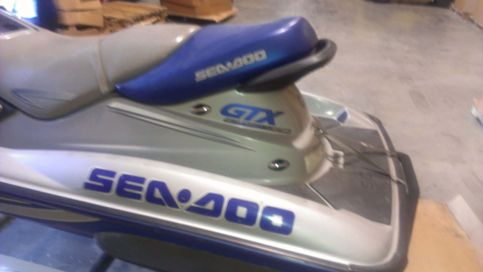

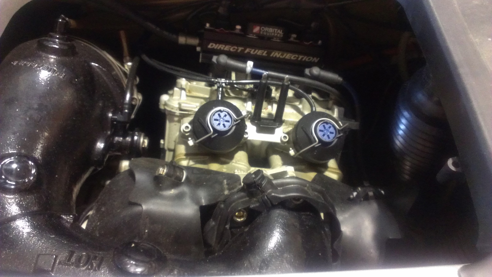

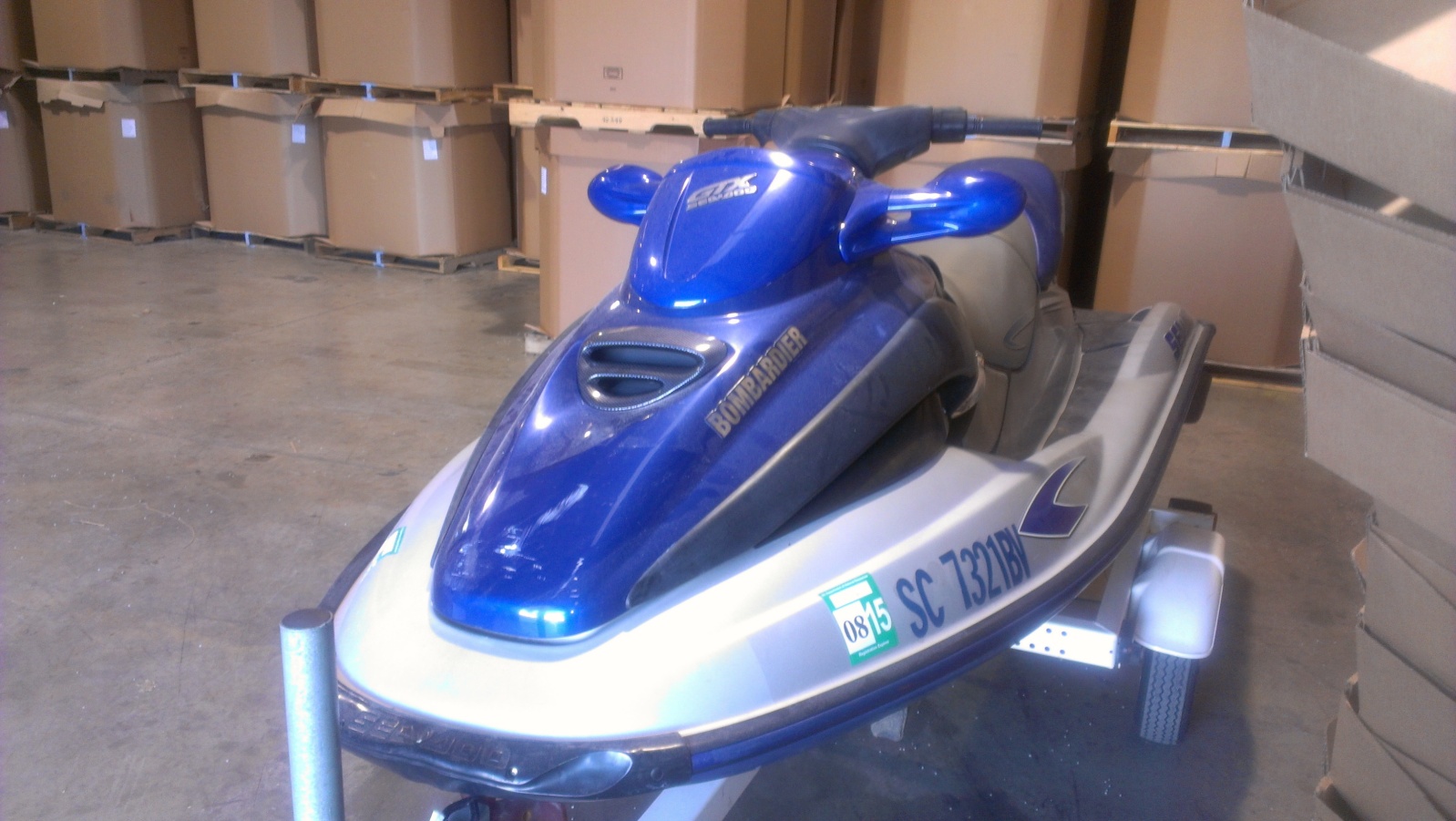

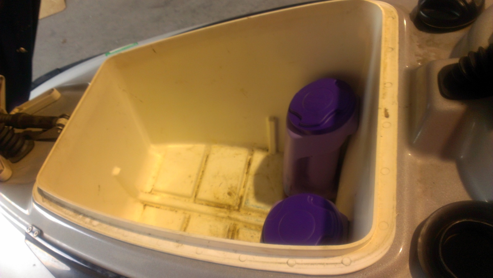

Well over the summer I bought my first ski 95 XP. I love it. It's super clean, no issues, fast, and fun. I have learned tthough its not big enough for 2 people to just cruise lol. No big deal we made it work but now its time for a second one. Yesterday I put a deposit on a 2001 GTX DI. Over all it looks really good other than couple scratches here and there no big deal. The ski has 116 hrs on and is the second owner if I remember right.
The guy just replaces the fuel pump, fuel injectors, and fuel filter since the old injectors were pretty bad from ethanol. I didn't water test it because its kinda cold and I'm sick at the moment but it started up perfectly in his shop and sounded fine. I'm just looking for advise on this ski since its fuel injected and I'm used to my carb. Im paying $2,000 for it which isn't a steal but don't think its a bad deal. Any help will be great and I will get picks up in a few.

WATER TEST IT.
I don't care if it's 45 out. you won't get wet on a GTX (unless you want to). so WATER TEST IT. a 951 should run 7000 WOT brand new, however 6800+ is acceptable.
you may have missed it, so I'll write it once more.
WATER. TEST. IT.
$2k isn't a bad deal, I've seen people pay over 3 for these.
i agree, with 2K invested, i'd like a water test
i'm also very leery of DI ski's unless this shop guy works for beer, and is your brother.
my rule #1 on DI ski's.. don't buy them, they are absolutely terrific when running, but when not, you can easily drop a repair bill with a comma in it....
Im going to arrange a water test before I pick up. Im not getting it till December. I also understand alot of people don't care for the DI and I don't know if its because they have carb models and think theirs are better or they really are bad. I feel that if you take care of something then you shouldn't have major issues. So what Im wondering is what is needed to be done to keep everything running right. Im sure there are plenty of guys out there that have these and are running strong. Long as they have taken care of them. Its such a nice ski to be that bad.
My negative response re DI's is simply the cost to diagnose & fix issues as compared to carbed models, nothing more nothing less. However if you have a good tuner and he works cheap, and your prepared for more expensive repair bills than with a carbed model, then you should be very happy with the ski. Just don't go in thinking its all going to be rose petals and puppies when it needs to be fixed.
Just keep in mind that DI's are a bit beyond the average DIY user, and many mechanics that are very qualified to work on carbed models will be leery of the DI.
A broken version of that model is for sale in my area right now... engine needs work, great condition otherwise, on a really really nice trailer, he's asking $600 and its been for sale for 3 weeks at that price, nobody wants it. If it had been a carbed model, it would have been sold on the first weekend.
the reason people say to not buy them are they have a faulty fuel system on them, and when they start having problems...they can get very expensive to repair because it is way more complicated than a carb or even RFI model (they have to have much higher fuel pressure) and often times people throw money at them hoping they have fixed their problem when they havent. That is all, yes they are great skis when running, but at this point they are 10 years old so alot of problems have started coming up around the forum. Plus they have the 951, which yes are great motors, but have a much shorter lifetime than like the 787. The carb models people can fairly easily fix their fuel systems for less than $200. And that includes carb rebuild and fuel lines and anything else you can think of
