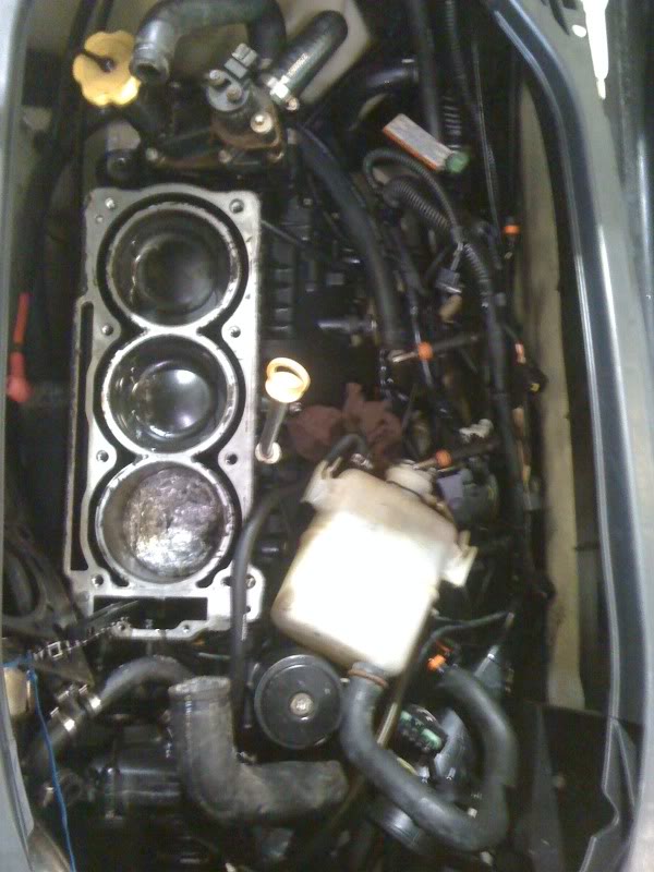

As far as a realistic benefit in a stock rec boat, yes and no. Only real pro that I can see is, it MIGHT aid in the preservation of the cylinder if the boat drops a valve. The 4 tecs, especially pre 06 are infamous for dropping exhaust vales. Usually when this happens, it chews the head, piston and splits the cylinder all the way through the block. So it's up to you.
Here's an example of an 05 I had..see the crack ? A block guard arguably could have prevented the block from becoming a pile of scrap. (It's prolly a budwieser can now)
That engine dropped a valve, and it would have been trashed regardless. :rolleyes: That damage had NOTHING to do with a cyl that walked.

Read my post carefully and tell me where I said that damage came from a walking cylinder....never said that. I said that damage came specifically from a dropped valve...9 times out of ten, when these motors drop a valve it blows out (cracks) the cylinder wall all the way through the block.. It is ''theorized'' by a few tuners, that in the event the motor drops a valve (happens more often than not on a 4 tec) that the block gaurd can potentially save the cylinder...that's all I said, period. I have personally witnessed a few motors live on after dropping a valve with a block guard.

That is 1 seriously banged-up piston in your pics, Spade! Ouchie! The engine can actually keep running after a valve head pops off? I'd have thought it would lock-up it's cylinder and kill the engine instantly!
