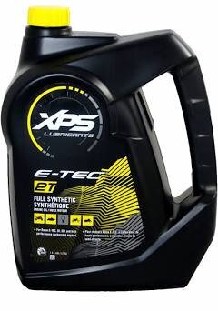

What’s the best oil for a low hour 97 787 ski? Not seeing any stuff that’s name brand. If anyone’s got a link to the good oil they use it would be appreciated.
Any synthetic oil rated Tc-API low ash will do, just don’t want an oil that’s TCW-3 rated as they are meant for lower reving, cooler running engines. Lucas makes one, just be sure you get the right one as they make some that wouldn’t be right for your machine. You may be able to save 10.00 a gallon with the Lucas. But yes, oil and gas are expensive
