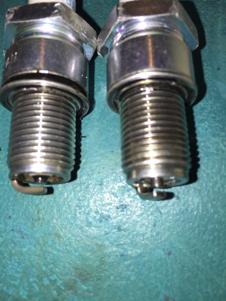

left plug is from pto cylinder right plug is mag. Mag cylinder has liquid in the threads and and pto plug has more on the electrode. Brand new plugs.
