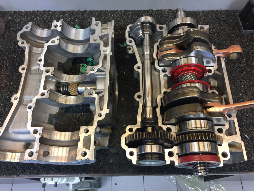

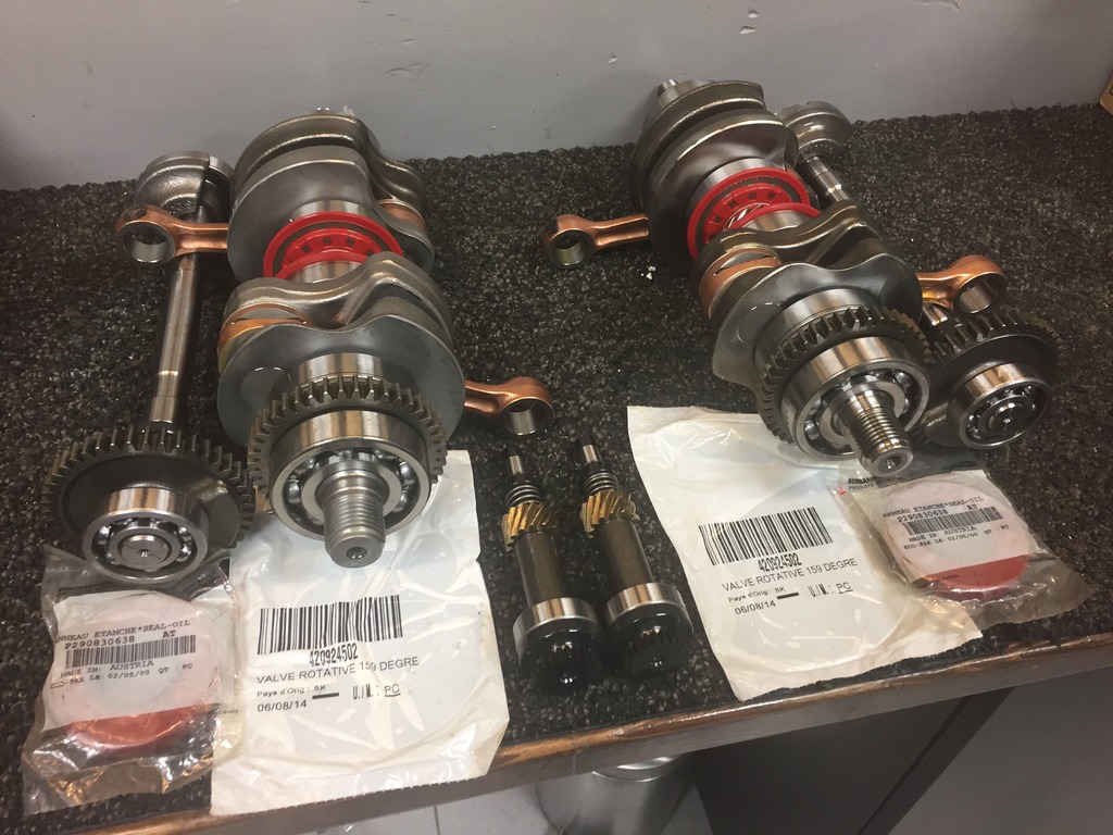

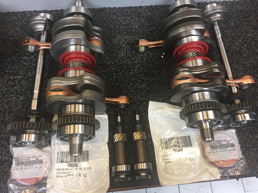

Cleaned the inside of both cases, polished the bearing mains, installed new OEM rotary shafts, new OEM crank seals (PTO and Flywheel) , new OEM rebuild cranks, new OEM counterbalances, and new OEM 159 deg wheels. I have everything together minus the cylinders and head. I should have my top end by this weekend so I'll finish assembly, steam clean and then paint next weekend.
Awesome job.
Just a question, the counter balance and main gears appear slightly misaligned. Is this considered normal positioning, or am I seeing something because of photo angling?
