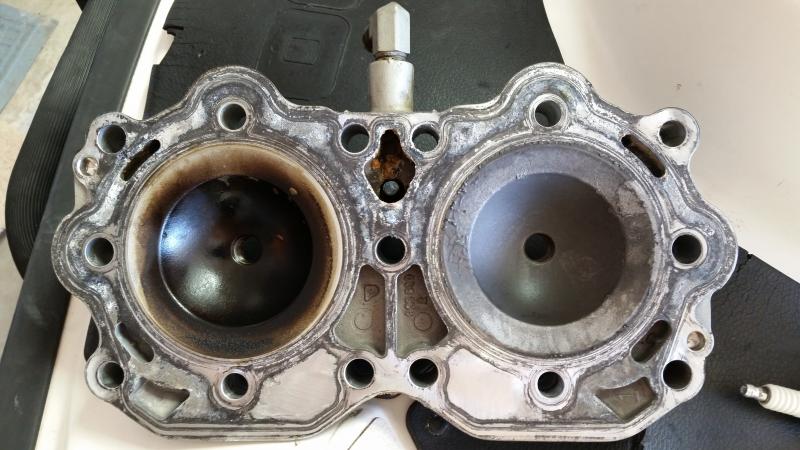

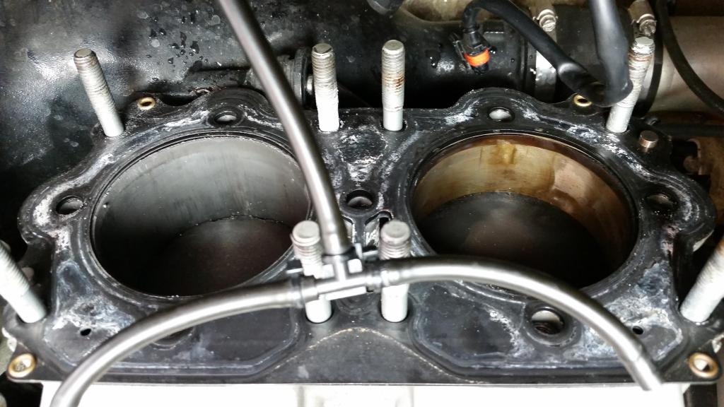

Went and took the jetskis out for a test to make sure its working. Well she ran perfect and i mean perfect for about 4 hours. We were just about to go home only 5 more mins and we would have been on the trailer going home. I was doing some donuts and i tried coming out of a sharp one and giving it gas all of sudden no power and died. I started it back up but it struggled to go anywhere. I let it sit to see if it was tired and such so about 10 minutes goes by i start it up and still no power at all. I limp it back to the dock and pull the spark plugs sure enough the electrode is bent in and small bearing balls are wedge inside of it. We get it home and pull the top end cover off and see one piston grey and broken pieces while the other one is perfect with oil. My question is what caused this:
1. Oil starvation?
2. Lean condition?
3. Water ingestion
4. Old tired parts
5. Rod bearing failure from what?
ill post pics soon.
great day for 4 hours then crappy day
I know right...crazy. We had a blast on these things finally from fixing all the gremlins and now this happens.
So how does it ingest water? does it come in from the exhaust side or the intake side?
I'm assuming the intake side right?
Question the intakes have that wide black box and then 2 ports that come up over the engine. Then there is these rubber things that kinda protect the open ports for these things. We forgot to put those rubber pieces back on would this have been the reason or is the water ingestion still an issue with them on since the air intake is on the bottom of the hull and could still take water in?
I saw that the PPG makes a nice air filter kit along with rejetting the carbs.
Hate to spend 400 bucks on a top end to just ingest water again. that will be frustrating to say the least.
We have owned our two ski's going on a year. These machines are a steep learning curve. Even if you have wrenched alot of stuff. No doubt, figure out what happened before you fix the latest Gremlin.
there is a problem with the 1998 gsx limited running lean i saw it reported on R&D website. it says to adjust the oil pump cable so it supplies more oil to the engine. also i learned a long time ago. to add a little extra oil in the gas.i have a ratio rite cup and i put a extra 100;1 mixture in the fuel. this will assure the motor doesn't run lean.looks like you need a total rebuild now. that really sucks. stay away from sbt engines heard lots of bad things from a friend who has a shop and won't even use them anymore
So i'm trying to figure out the root cause of the failure. After looking at it closer the PTO cylinder still has the cross hatching on the cylinder and shows that it's in really good shape. The MAG cylinder that blew has a stressed crack down the piston and the skirt is half broken off which contributes to the grey color and all the debris which contributed to scratching the cylinder and eventually pushing the spark plug in. More i think about it i dont think this is water ingestion because most ppl say water ingestion causes bent rods and usually no scoring on the piston? Also the wrist bearing and rod bearing are in good shape. If it was lean i would really think the spark plug would be white and not tan as well as the bearings fried up. it's almost like the piston clearance to the cylinder was not setup properly and rocked itself to disaster?
In theory how fast would a piston blow up with lack of oil? I wonder if the spark plug never would have gotten hit if the piston would have seized up eventually. That might have saved the bottom end since the engine basically shut down immediately instead of just running either with no oil or lean condition.
