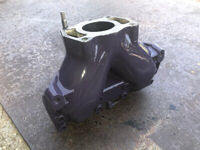

S Seadoo Tuner Member Aug 22, 2023 #1 Stud broke on the Seadoo GTI 720's exhaust manifold - is this a screw in or press in? Trying to figure out how to extract and replace.
etemplet Moderator Moderator Aug 22, 2023 #2 Screws in. Drill it and insert a Helicoil. Or you can buy a used manifold. Good Luck !!
mikidymac Moderator Staff member Moderator Aug 22, 2023 #3 They almost always break because the rubber support washers are worn out. If you don't replace them they will just break the bolts again and again.

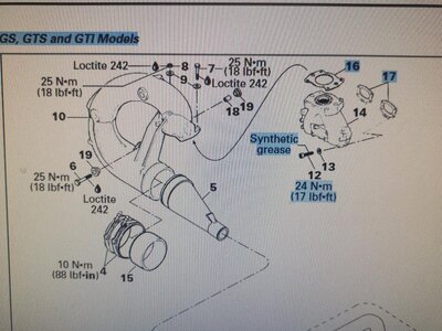

S Seadoo Tuner Member Aug 23, 2023 #5 mikidymac said: They almost always break because the rubber support washers are worn out. If you don't replace them they will just break the bolts again and again. Click to expand... Just to confirm, the rubber support washers (2 pieces) are on the horizontal bolt only, number 19 in the diagram below correct? Attachments gti diag.jpg 187.5 KB · Views: 7 Last edited: Aug 23, 2023
mikidymac Moderator Staff member Moderator Aug 23, 2023 #6 Seadoo Tuner said: Just to confirm, the rubber support washers (2 pieces) are on the horizontal bolt only, number 19 in the diagram below correct? Click to expand... Yes, that is correct.
