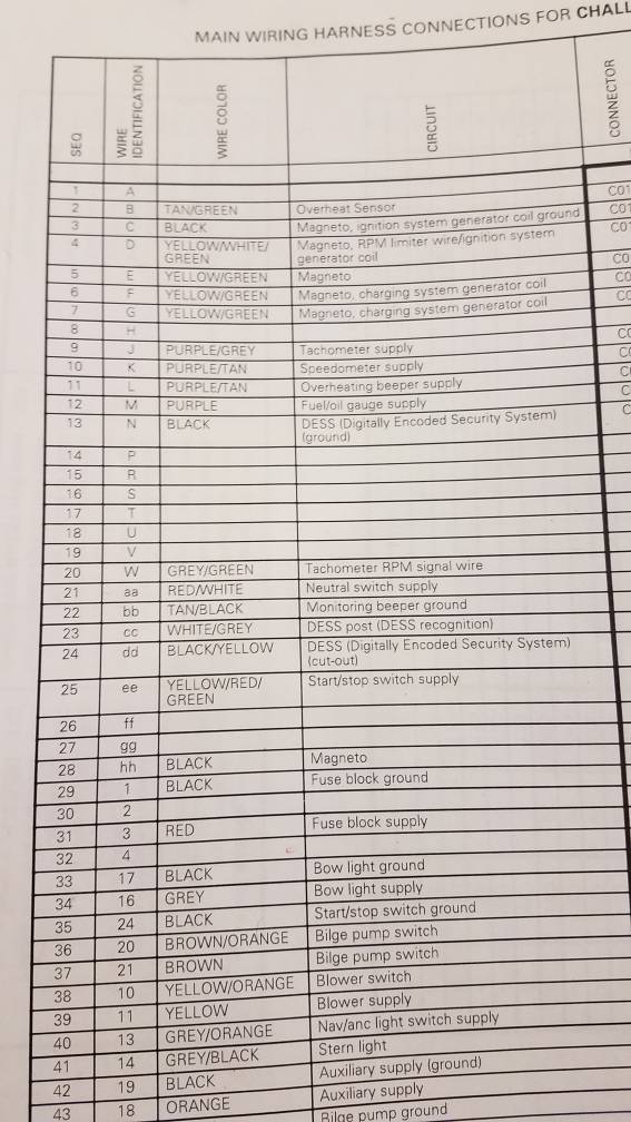

I got the wiring diagram and the chart fromseadoo customer service on my 1996. Here's the chart. Let me know what else you need.
Thank you so much for your help
But I've just went through the wires and mine is different
It must change for 1998
