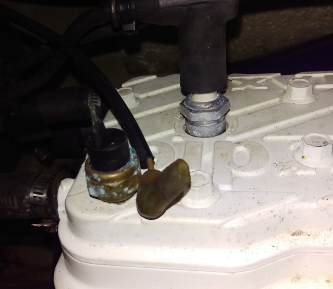

I figured i would just take the temp sensor from my 96 and try it but they are different, has a previous owner changed something or did they change it in 97?
Here is the 97:
Here is the 96:
Replace the temperature sensor
