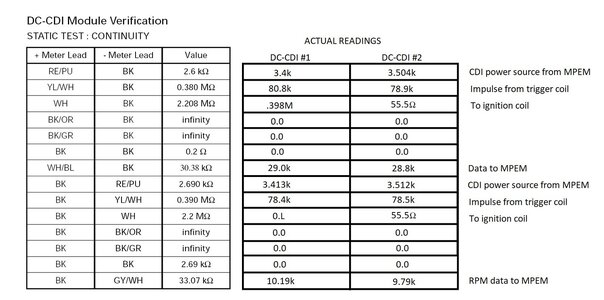

A short run up. Everything tests good with all the Seadoo manual tests and a multimeter. Ignition coil, MPEM, Trigger coil, Stator etc etc. All within specs. I'm not getting a pulsing light when I test my white wire at the rear box though. The white wire has good continuity from inside the rear box to inside the front box so the wiring itself is good it seems. The wiring in the whole ski is very clean actually, very little corrosion throughout.
That all being said, the only component that doesn't test to spec was the DC-CDI box. All the tests were way off spec (see attached graph). So I bought tested a different one (which I thought was off a running ski), with almost the same results. So then I tested a third in some guys garage on one I was going to buy (didn't write down those figures) but the were almost exactly the same as I remember.
Did I just get my hands on three bad DC-CDI boxes? Is my luck that bad? Or am I missing something?
It would be SUPER HELPFUL is if someone had a 100% known working DC-CDI box from this year and ran these same quick multimeter tests for me. Just maybe the first three on the chart I've attached (RE/PU, YL/WH, and WH)? Or tell me from personal experience that all three of these boxes I tested ARE just bad. I just hate to spend $200-300 on another used DC-CDI box and it not be the problem.

That would be amazing. My goal is just to know what an actual proven running ski tests at. If a proven running ski still has Ohm readings that are all over the place I'll feel less secure about the DC-CDI being the problem. And vice versa.
The only other thing I'm thinking about is that pickup coil not being close enough to the flywheel. But I'm not aware of a dynamic test to check the signal (the static test for the pickup coil passes though).

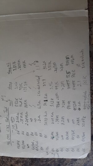

Here's the readings I took on 3 CDIs. They were all good.
Very interesting that a lot are not in spec but the DC-CDI is perfectly good. Throws a real wrench in the gears over here because now I can't trust anything I see. Ugh. Thank you so much for taking the time to submit these!! I think I'm going to pull my stator cover off and somehow try to confirm the pickup coil is in the right place. It's the only thing I can think of at this point. And a long shot since I just buttoned it up fresh on the rebuild and am pretty sure it's good.

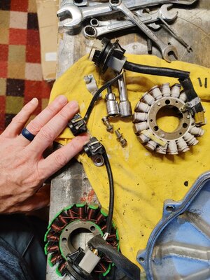

Just to put a nice pretty bow on this thread, I found out my problem.

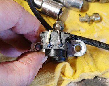

When I bought this ski (in rough shape) the previous owner said he put in a new stator in while trying to chase down some type of "imaginary" electrical gremlin. In hindsight I now realize that he installed an Ebay special stator. When I had the motor apart it looked good and I static tested the stator and trigger coil and they both passed every test. But that crappy Ebay sh*t was the issue.
The problem was that my Ebay trigger coil shape didn't match the OEM one. It's too short. Therefore it wasn't reading the flywheel marks as they passed. Into the trash can you go. The funny part is, that the OEM stator he gave me was just fine. I'm not sure why he replaced it. <facepalm>

Yep, the Trigger Air Gap is critical.
Something that's always checked on A/M Total Loss Ignition Systems but usually not on Stock OEM Systems.
Chinese Parts are always a gamble.
