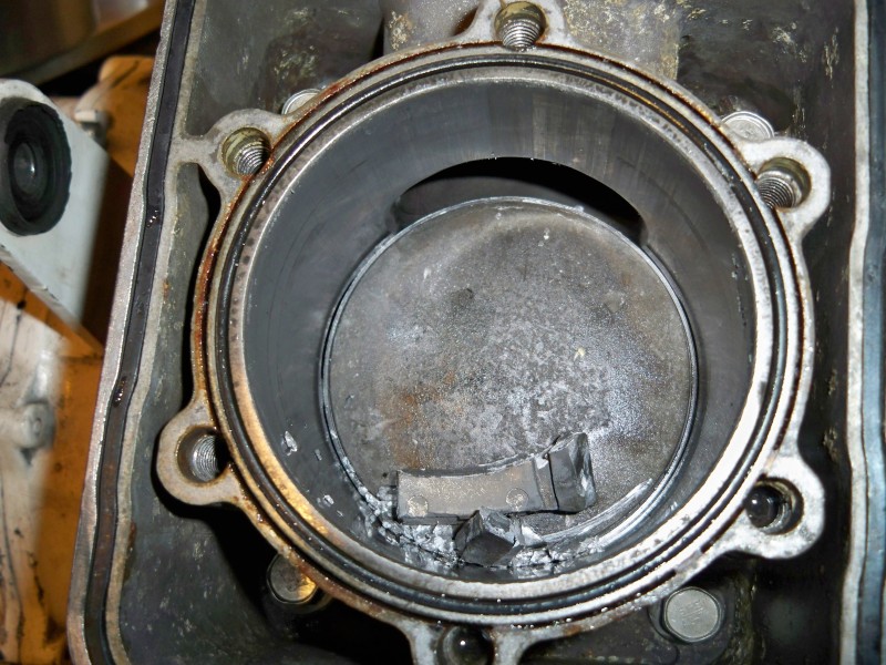

I can tell you what it is....the shaft on the rave and the housing are wore out. When they leak oil after a complete rebuild and everything is put together correctly.....you are on borrowed time.
When they are that wore, the rave is vibrating ALOT and will eventually lead to this...
My 787 keeps melting the plastic plunger. It's happened twice now, i open the cover, and the boot is popped off a messed up looking plunger with a rave sticking through it. When the raves are worn, do they generate too much heat when they vibrate?? Or am I running too lean on the MAG cylinder?
