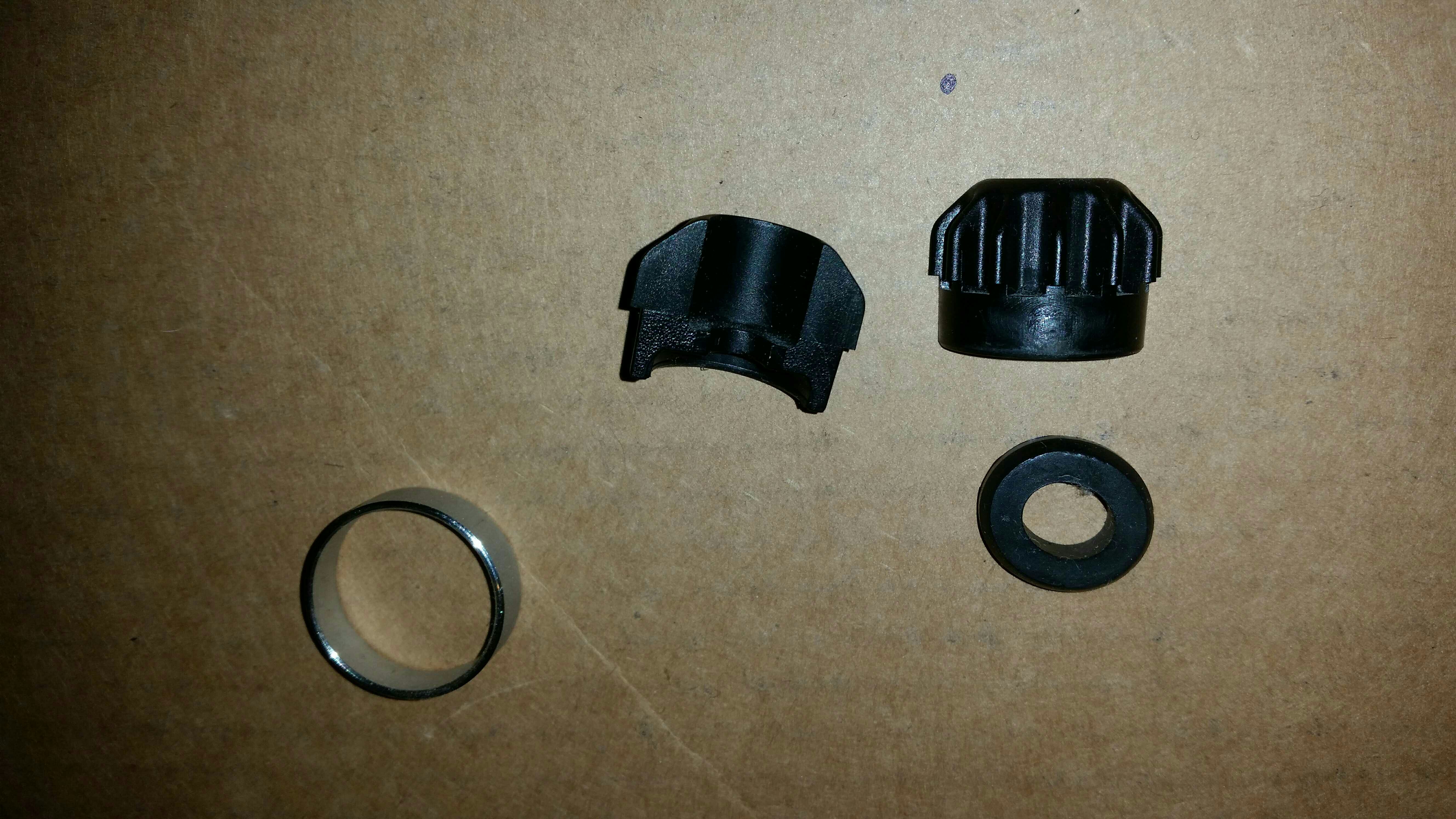

I took a few more whacks with a hammer before resorting to breaking off the plastic half-rings. I dug them out, pulled off the metal ring, and pried (took a lot of effort) off the rubber stopper. Guess what? The cable STILL wouldn't move!! I put up a board against the back and took a sledgehammer to it--with some caution not to damage the hull. Still stuck! It looked like there was adhesive sealing up the cable in the hull hole. I hooked up the pliers again (inside hull) and twisted/turned, and after a great deal of effort it eventually broke free. You can see the powder/residue from what was surrounding the cable.
I'm glad I broke off the plastic half-ring as suggested, because the previous method (which likely would have worked if not for the adhesive) was getting me nowhere. I assume that there should not have been any adhesive sealing the hull, and that only the rubber stopper (from half-ring kit pictured above) is needed for that purpose? Please advise so I can do a proper reinstall.
A special thanks to all those who have commented and offered help--after several years it's finally almost done!
That white stuff looks like aluminum oxide. A small dab of silicone probably won't hurt honestly I don't remember if I put anything on the last one I did
