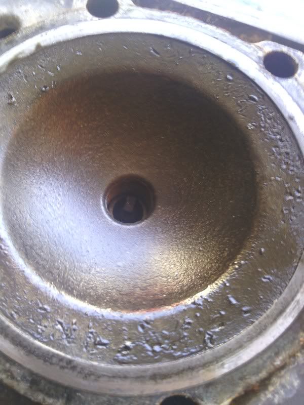

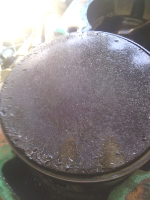

I pulled the motor tonight and pulled the head. Looks like the back piston was hitting the head at the top side of the piston is all pitted along with the edges of the head. motor turns over find with the head off. I'm thinking crank bearing failure is the problem. I'll be splitting the case tomorrow or this coming weekend.

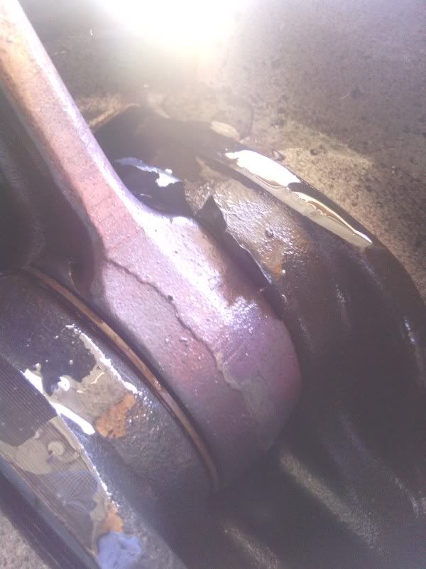

Well I got the top half of the motor off and it's a lower connecting rod bearing failure. I haven't got to crank yet but I'm going to do the bearing on it anyways just to be safe. I don't know why it wont me let me post pic so here are a few links to my photobucket page
Lower connecting rod

Piston

Head

I'm going to go with that the bearing or thrush washer got hot and blocked something in the oil pump, hence it not using oil for a period of time. I just got more use out of it buy mixing my gas/oil.
