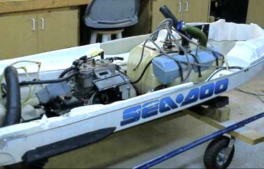

Any suggestions on removing the Fuel Baffle on a 96 GSX. Do you have to take the engine out? I have removed the steering, but there just doesn't seem to be enough room to pull the baffle out, even with tilting the fuel tank.
I have a problem with air getting sucked in the fuel line. So far the Fuel Selector and water separator/filter passes a vacuum test. All of the fuel lines have been replaced.
Any help is appreciated.
