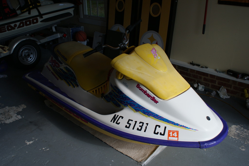

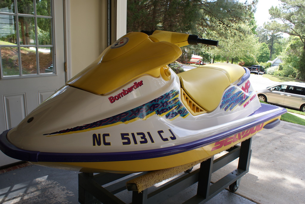

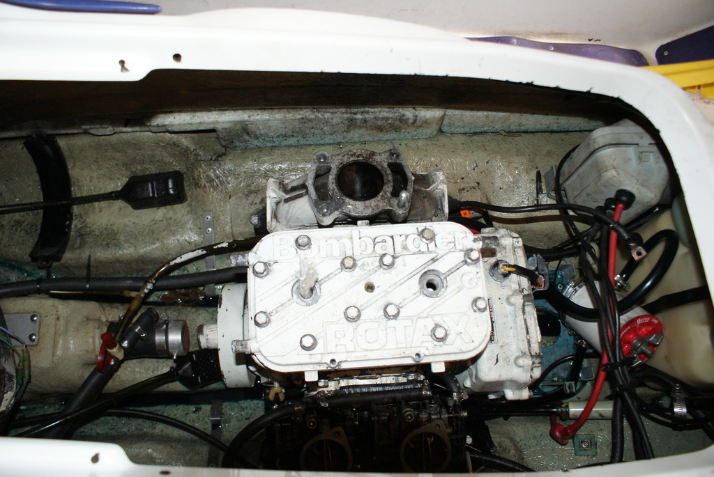

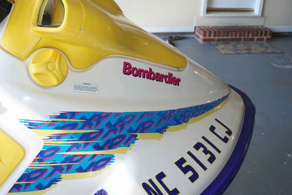

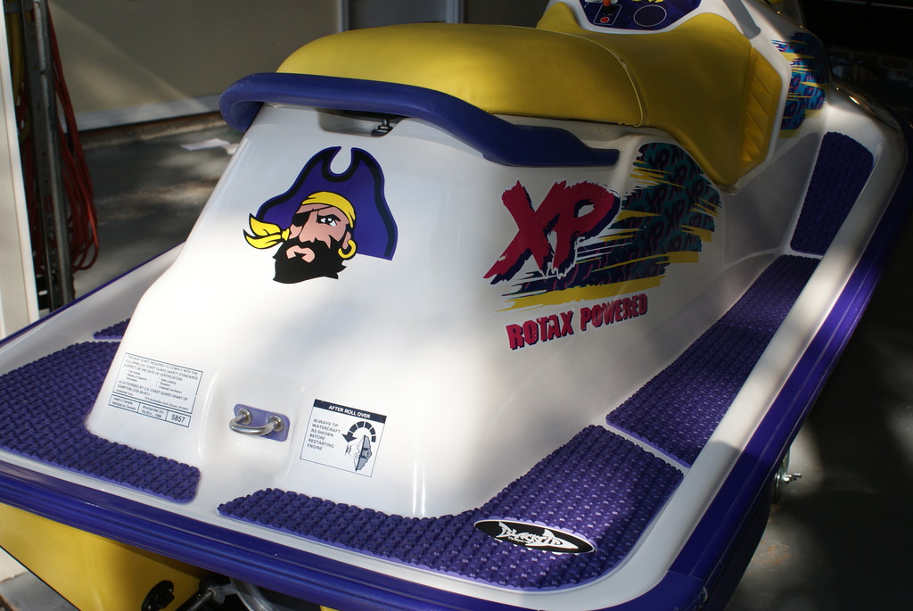

The winter project is over! Late last summer I picked up a 95 XP for $300 from a local kid….the ski had been neglected but was itchin for a project. Rebuild included:

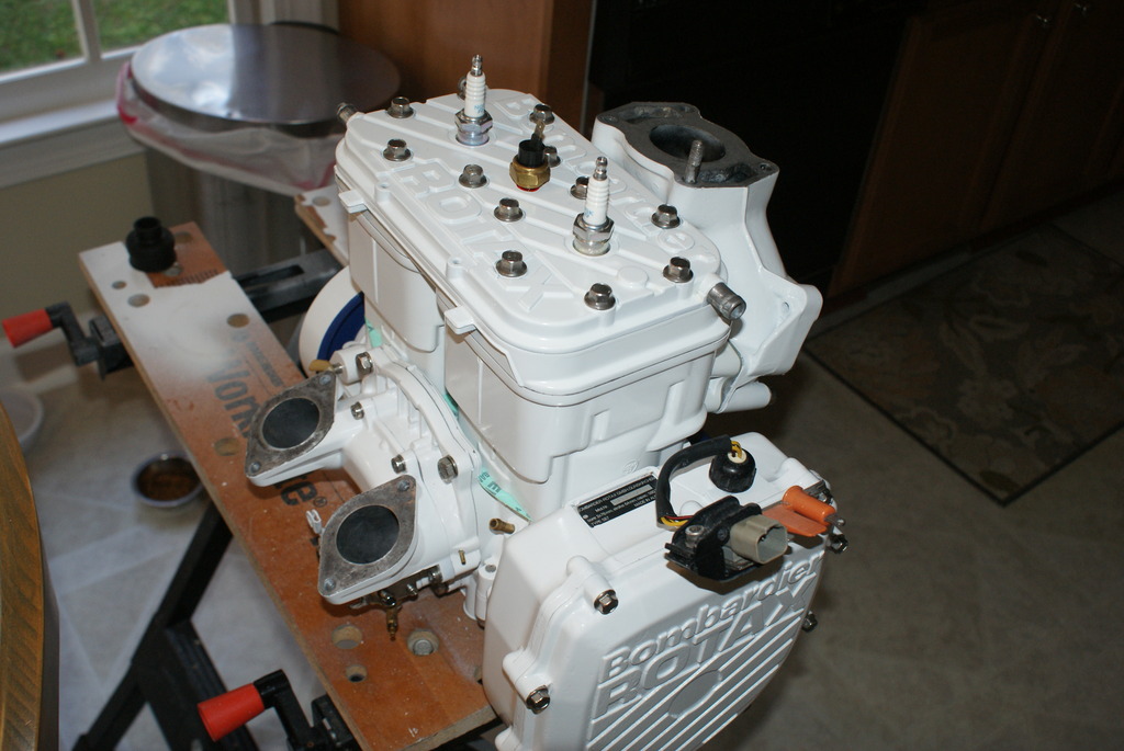

New rebuilt crank. Top end w. WSM pistons (I know not the best but within budget) Full Bore did the bore work. I compared local pricing but as we know the rebuild shops offer off season price breaks.

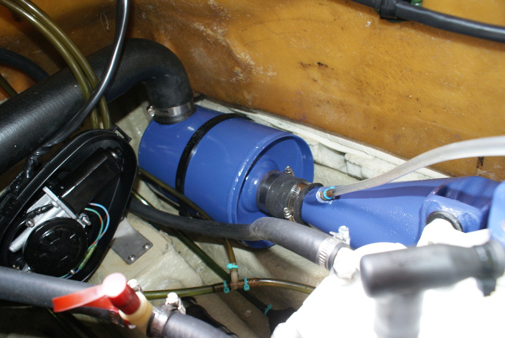

Rebuilt carbs w. Mikuni kit plus new fuel lines & selector, pulled fuel and oil tank and cleaned and pressure tested.

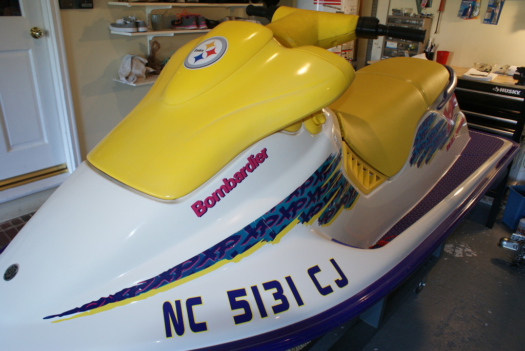

Hand sanded and polished the hull, had to do some gel coat repair (thanks [MENTION=62942]jammin777[/MENTION]) added new BT traction mats.
New wear ring, replaced the seat cover & rebuilt the starter
Last weekend I cranked it for the inaugural start. Fired right up ……Brwrappppp! I was tickled. Can’t wait to get on the water to begin the break-in.
Thanks to all the forum members that provided support during the rebuild.
Thought I’d share some pics of another Seadoo saved.
Searching for the next project :)

Wow great work! It's definitely worth five times the buy in price now(at least). The 95XP is such a good model also. The performance and reliability are great even by today's standards. In my opinion the ski you just made is better then a new 5 thousand dollar Spark(7 thousand haha). Your gonna love that ski. The pump extension makes a big difference for top speed and turning/trim response.
good job rob! very nice! i plan on taking mine out for the first time this year next friday. have fun breaking her in.:)
mine should run right after replacing the fuel pressure regulator. it was shot.
Thanks guys...it was a fun winter project. Was hoping to get out today but the damn storm Ana changed those plans.
Kevin - I wish you well on Friday. I know it was a trying summer for you last year. Glad to hear that you got the issue resolved.
The 95 XP was my dream machine when i was kid. I would go to the dealer and just look at it. I use to know all the tech specs off the top of my head. Great work PGHMAN the seadoo looks like it is in the same condition as the ones i use to drool over. Well still drooling over the photos
Lol Go Pirates. The colors on that ski are a good match for the ECU colors.
