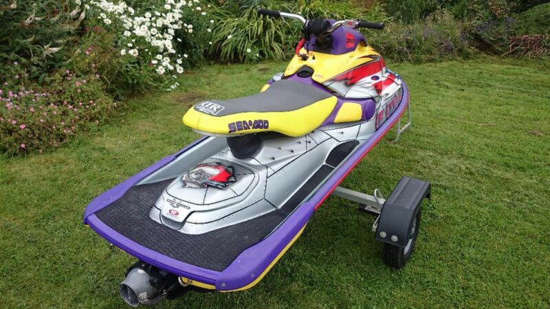

my question is... i have a 95 seadoo hx, stock 717.
ive rebuilt the carbs using genuine mikuni kits, new needle and seats (1.2) genuine mikuni and changed the springs as they ones in there didnt match and given its a 21 year old ski thought best.

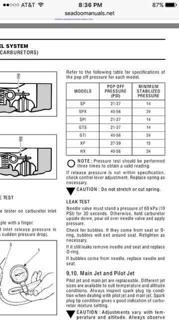

ive done some research, and a few sources on the net as well as this forum have stated the pop off should be in the 40-56psi range yet my manual that came with the ski says 20-33 psi?
im literally going through this ski piece by piece and would like a fighting chance to make this beast fly again how it should so could anyone please point me in the right area as to which psi range is correct? ive messaged racerxx and 96spxpos whos been helpful (thanks) but would like some advice from the masses
cheers look forward to your ideas.
