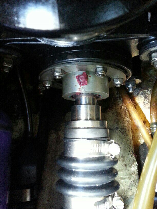

- Is the output shaft in the rear of the ski supposed to slide out and make contact with the carbon seal once the ski is running? There's lots of play between the carbon seal and shaft at the moment.

Number 37 in the diagram above is what I was asking about moving outward when the ski is running. I can pull it by hand. Is it not supposed to move?

If the driveshaft stays stationary and JUST that piece can slide on the shaft then you have to replace the o-ring that is on the shaft. You need the updated C-clip. You will have a major leak and probably cavitation if you leave it like that.
Just to be clear, you should ONLY be able to slide that part towards the pump, not the engine.

I guess its more of a collar that I'm talking about it. See how I can pull it back? Is that normal, or is it supposed to be out all the time?

It should pull back. Keep pulling back until you see a groove cut in the shaft. That groove should have an o ring or preferably the updated c clip. If you have neither that won't work.
To me it looks like you are either missing the o-ring or the c-clip. You should not be able to push the sleeve all the way forward and touch the carrier seal like your picture shows you doing.
I think you're right. I'm not pushing the collar, I'm pulling it. It returns to that position when I let go.
Here is the proper distance. Mine also has the heavy duty carbon seal set up from osdparts.com. I can almost guarantee that you still have the o-ring, my 95 had it. Switch over to the c-clip.
As far as grease, just be careful you can sometimes push the seals out. On my OSD carrier bearing kit they tell you to install the seals backwards so the grease will seep when you pump it. There is a seal on the inside too that you can't see, slow and easy.
Here is the groove you want to see, this is where the clip goes and that stainless steel piece you pull back on will slide over the c clip to hold it in place.

Is there something I could use in place of the C-clip until I can get one in? I'd like to put this in the water this weekend.

Yep, the C-clip. I wouldn't half bake it, you'll sink. Go to your local dealer they should have it in stock.
If you're totally boned out on riding it, the thick plumbers solder would work. The clip is just about .125" (1/8"), plumbers solder is .118". Just cut a piece so it goes end to end and try it. DISCLAIMER: You're on your own, I accept NO responsibility if you sink.
We don't have a local dealer, which sucks right about now. I might try the solder, but i think it might be too soft... I have to put an order in for a bunch of chit.
Nah, the solder should be strong enough, they used a cheap rubber o-ring. It's an interference fit.
