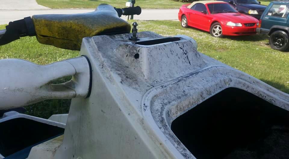

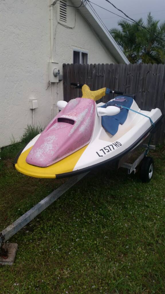

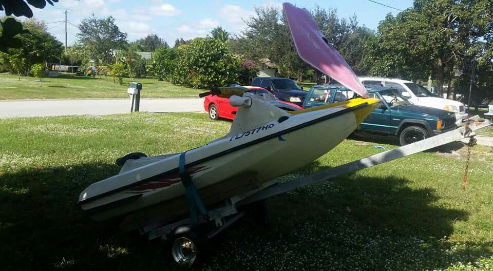

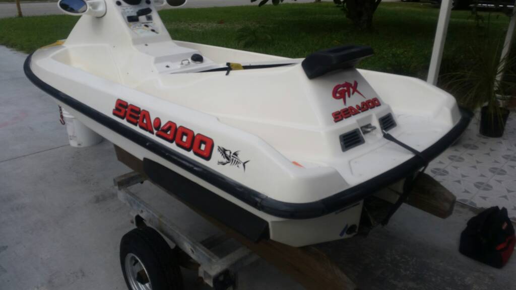

Hey all, I'd like to post My newby Seadoo project to all of you..first off, I'd like to thank everyone thats helped me answer some of My questions along the way, you guys have been awesome in helping Me decript some of the mysteries involved with this ski. This seadoo i bought back in febuary from a guy locally, i can tell ya it looked like it was pulled out of swamp, but i decided to take a chance on her anyway. I paid the man his money then towed it out of his backyard where it sat, seemingly rotting away. So, anyhow.. here are some pics of My progress so far, ( more pics to come ) hope you enjoy it and thanks again

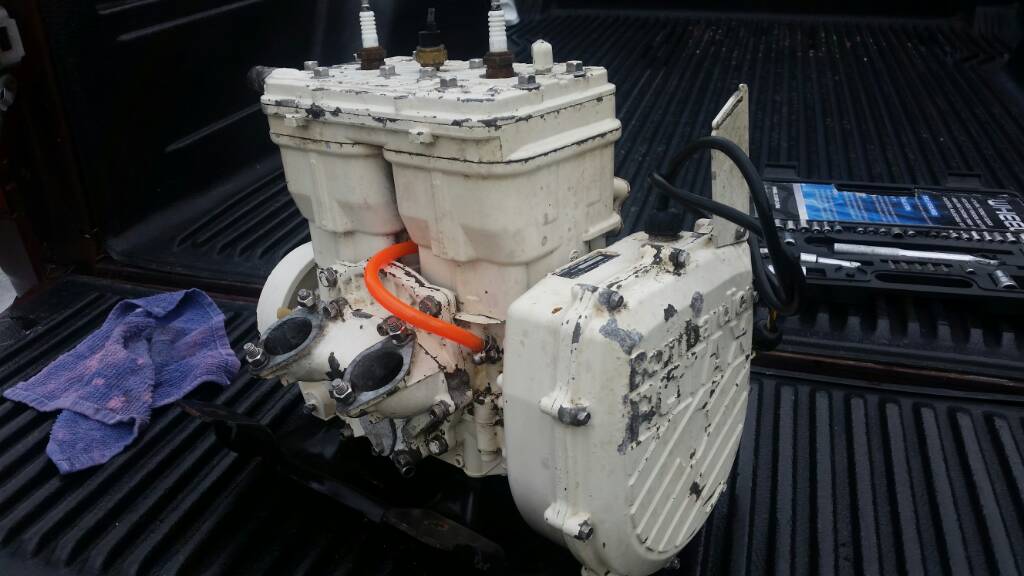

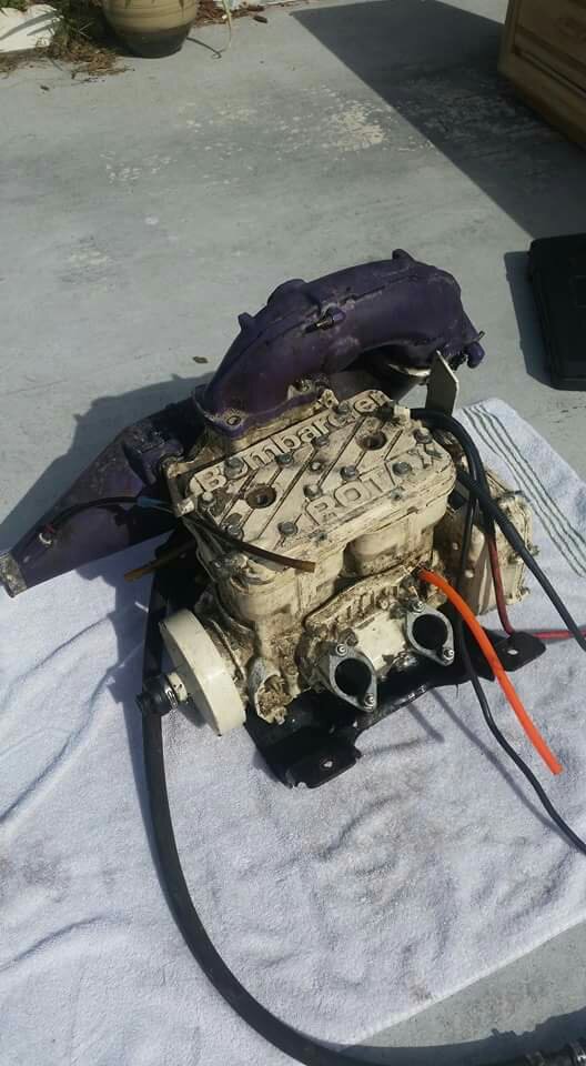

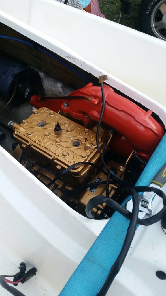

Pulled the engine.. took it the local car wash with a bottle of Purple Power and degreased the hell out of it
Sent from my SM-G900P using Tapatalk

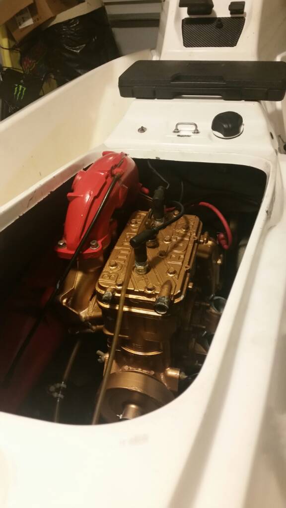

Sanded and wire brushed the motor as much as I could then bought a can of VHT gold metallic engine enamel.. 3 coats, then 3 coats of clear enamel.

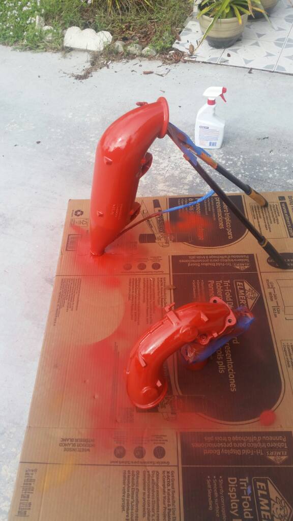

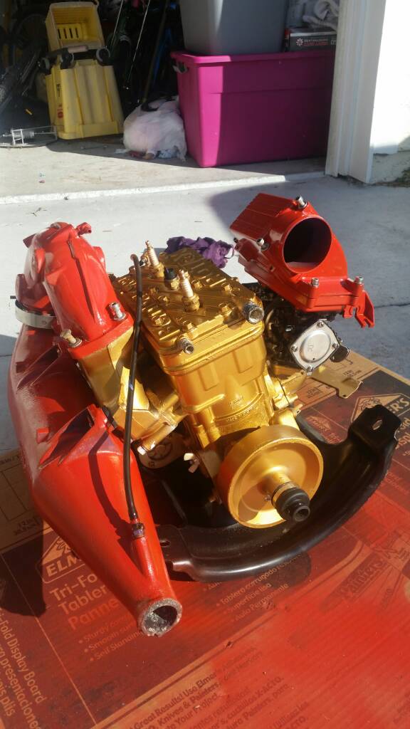

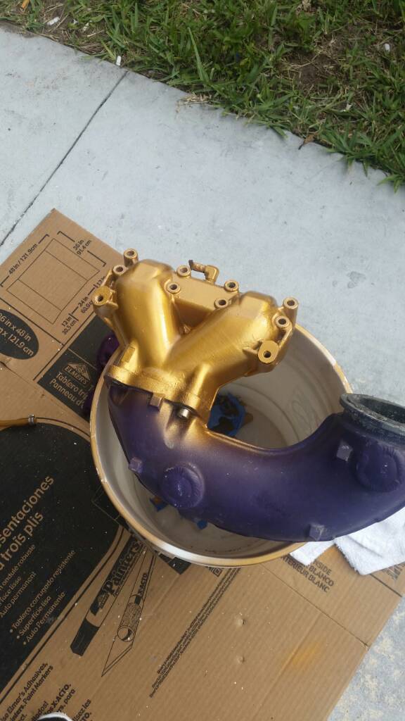

Couldn't get the exhaust manifold off so I lefted it attacted..o well, I chose Chevy orange engine paint for the pipes only because it was in sale at the time. Also applied a hearty coat of clear to these as well.

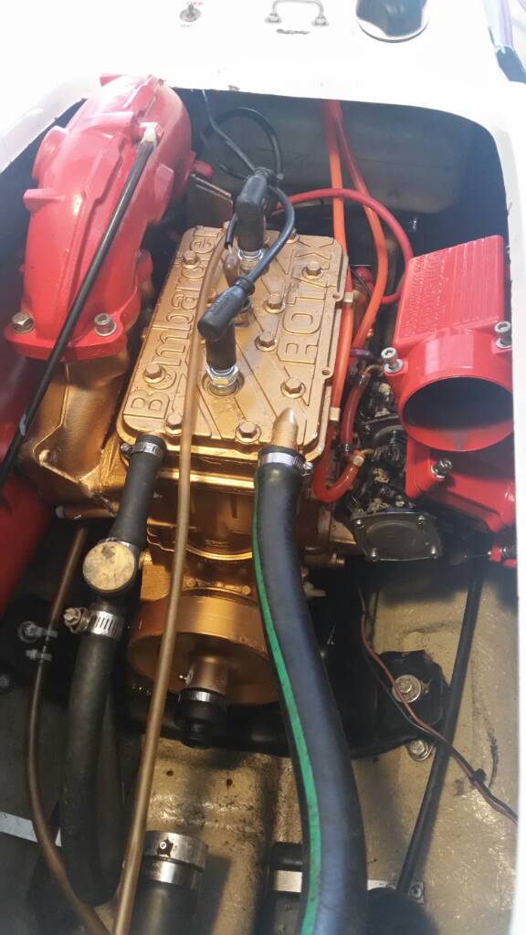

Finished the painting portion of this motor, the first word that came out of my buddy's mouth when he saw it was "Iron Man!". Haha, it was completely unintended, but I'll roll with it!

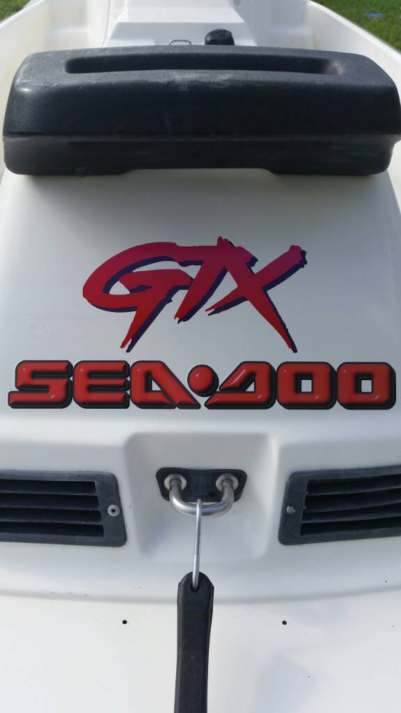

I trying to search for a complete set of OEM decals is like trying to look for Jimmy Hoffa's body however, I did score an original "GTX" logo that was meant for the hood. I placed it on the stern instead. It's my favorite piece.

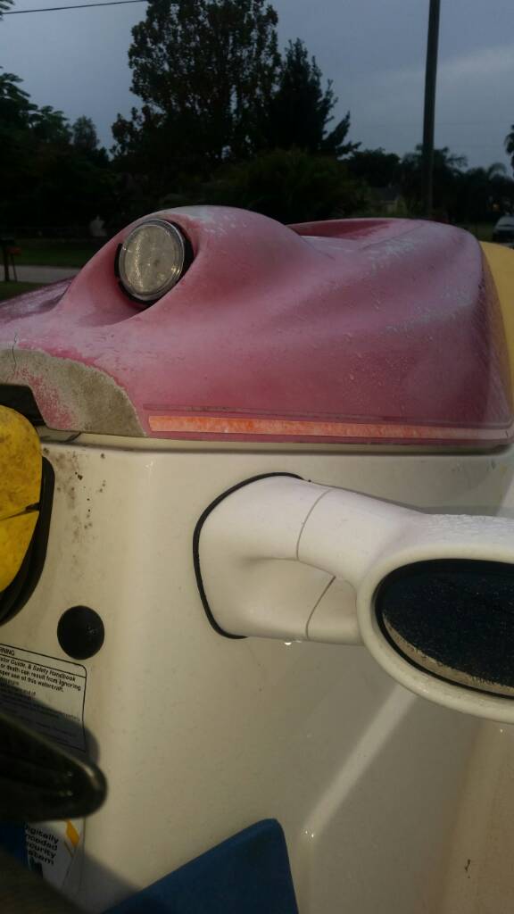

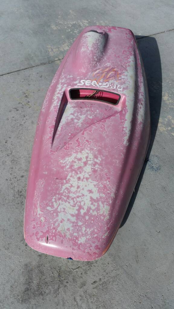

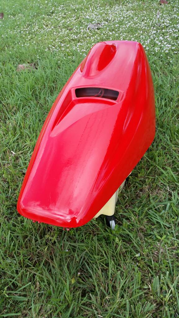

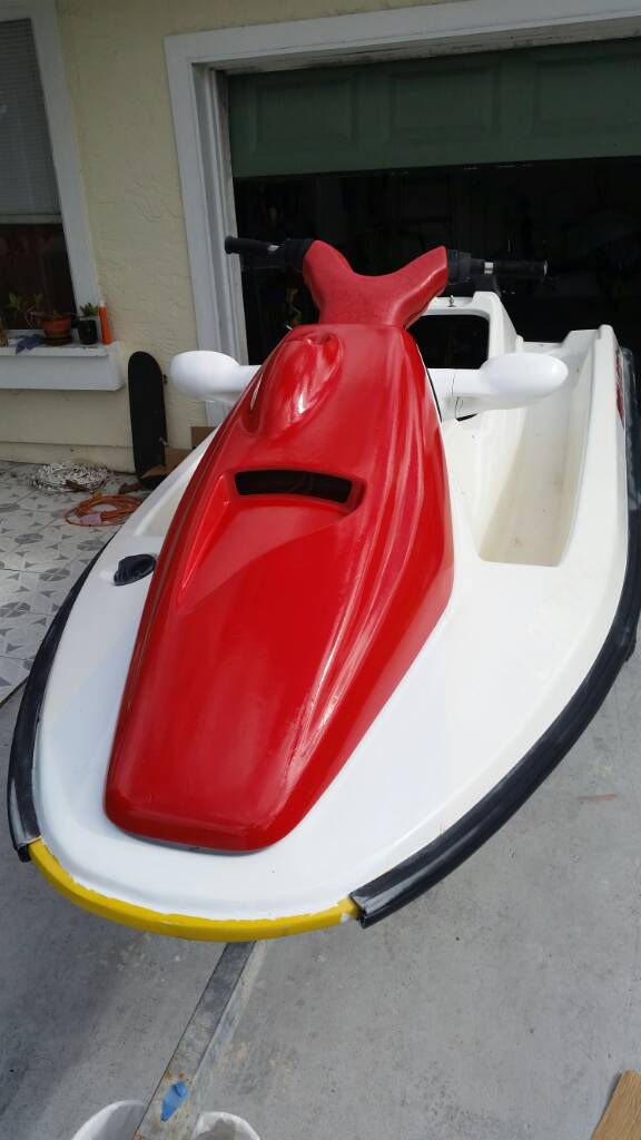

On to the hood, put the wifes hair dryer and a plastic scraper to the old decals and pin stripping and sanded. I originally went with a silver color, but i just wanted to go bolder. 3 coats of gloss apple red and 3 coats of high gloss clear. Also plasti dipped the chin pads red. IMG]https://uploads.tapatalk-cdn.com/20160114/012b0d5c182f35e0de4e8a011c7e0386.jpg[/IMG]

Also painted that ugly yellow stripe on the bow, used Rustoleum 2X gloss white

Looks like you are missing some rub rail/front bumper to me

Yup, i have the front bumper with me in my garage still, I've been busy with everything else that i haven't had the chance to do it yet
