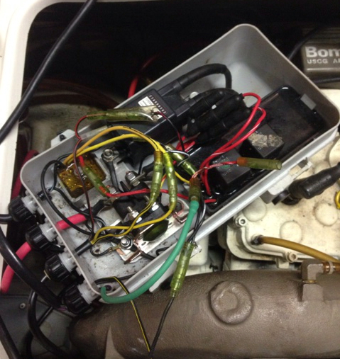

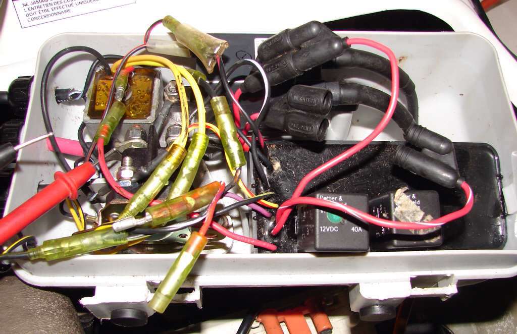

Here are the pics JunkYardDoggie wanted to post
I cropped them to save some space.
So are you saying that with a good, "non" blown fuse in place, & before you hit the start button, you don't have 12V on the yellow/red wire? Pull that wire off the solenoid so its connected to nothing & hit the start switch. Fuse still blow?
I think I see something I don't like....
On the solenoid, is that black/white wire on the same post as the yellow/red? Thats a problem,,,
What wires are where on the solenoid.
The two large posts should have the large red wires and one normally has another small red wire that feeds the MPEM (On the battery side).
On the small terminals one is the ground and one is the start wire from the push button.
Talked to Carl and he said that the black and white wire was on the wrong solenoid terminal. Switched the wire to the other terminal and all switches are working. Machine is cranking over nice now with the start switch. But still no spark. I switched over to my other MPEM that I had, now it will start and run. Problem solved for now. Next I will have to get into the carb, since it dosen't want to idle.
