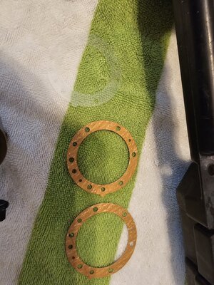

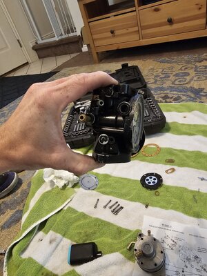

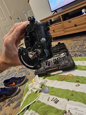

So I'm rebuilding this carb. And I'm curious if this diaphragm is supposed to have all these gaskets. It has the two brown and the clear one that came off it when I pulled the cover. Is it really supposed to have that many? 20230811_202859.jpg20230811_202910.jpg20230811_202621.jpg20230811_202645.jpg

I wish I could help, but I really know anything about your carbs. They are pretty rare. But I took a look at OSD marines website and they only include one of those brown round gaskets in their kit.
OSD Sea Doo Complete 587 Round Body Single Carb Pkg (1988-1990) [OSD1100] - $44.99
I also looked at the shop manual and it only shows the one brown gasket as well. You can download the manual here:
1990 SeaDoo SP, GT Service/Shop Manual - FREE PDF Download!
This leads me to believe you have too many pieces in yours.
