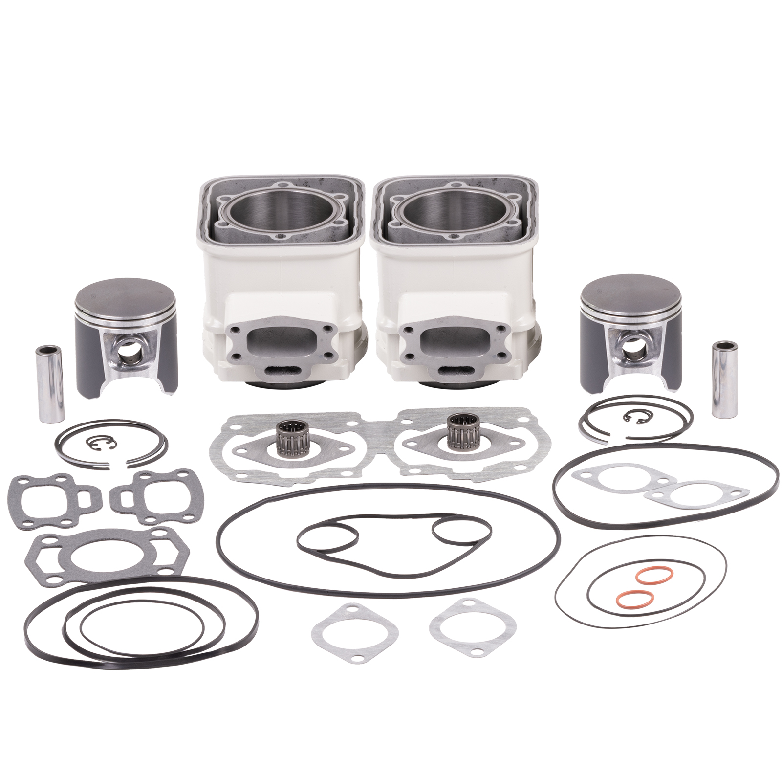

Here is a standard 657 kit...
657 XP /SPX /XP 1993 1994​
Brand: SBT
Code: 62-103
Quantity in Basket:None
$379.00
Here is the 657X kit....
657 X GTX /SPX 1994 1995​
Brand: SBT
Code: 62-104
$495.00
Brand: SBT
Code: 62-103
$379.00
Brand: SBT
Code: 62-104
$495.00
