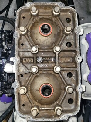

I wish I could be more help. I've only gotten as far as pulling engines out and reinstalling. This is what's under that head plate after removing the 11 bolts holding it on. I believe your '91 has the yellow motor.
