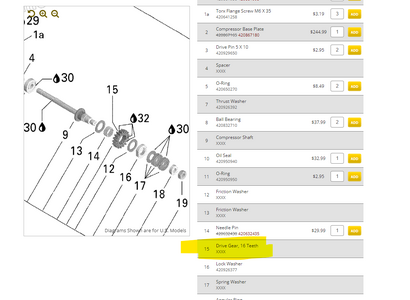

I hear that the supercharger should be rebuilt every 100hrs but does it always need a full rebuild or just the washers replaced? And why is the kit for the 185hp version so much more expensive than the 215+ version? I'm looking at a 2004 GTX with an unknown history that hasn't run in several years so I want to do what needs to be done but not necessarily replace a perfectly good shaft if it doesn't need it.
