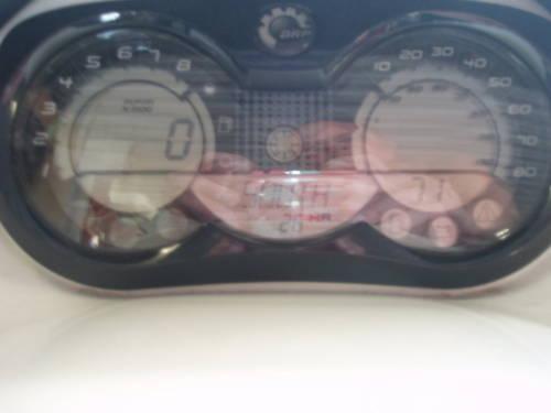

I have my eye on a 2007 RXT with 26 hrs on her. The price is $6100 w/o trailer. Does that seem like a good price?
It doesn't have the washers changed out on the blower.
Seems like a pretty fair price. The 2007s usually have been going for about 10%-20% more than that from what I've seen. As you mentioned, definitely needs the washers changed so maybe you can bargain down a little lower.

I'll see the ski on Wednesday ...if it doesn't sell first. I don't want to buy it sight unseen being it is 400 miles away.
Thanks for the advice you provided. :cheers:
I was able to haggle him down $300 because of the washers needing to be changed out. He had got a quote of $250 to have them changed and I wiggled another $50 out of the deal.
