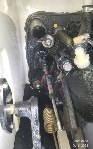

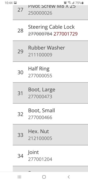

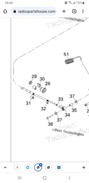

Please help! I have a 2006 GTX Sea-Doo that has a broken nut. The diagram calls out a different number. What is this part I need called? See attached pictures.

You don't have to pull the cable out at all. It's very easy to replace. Pull the pump and replace, simple. The old black version didn't last long which is why the improved white version was implemented. There are aftermarket brass and aluminum versions that are better but the white ones are a big improvement.

Really appreciate it - I'm finding multiple aluminum options on Amazon, but all of them have reviews that indicate different types of incompatibilities with the thread patterns or diameters. OEM sounds like the best option for guaranteed fit.
