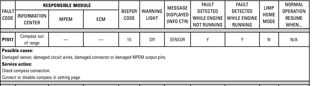

K Kenzeon New Member Sep 29, 2023 #3 skiasylum said: View attachment 64234 Click to expand... Thanks for this, Where is this sensor? I have checked the pwc diagram and I just can't find a part number or the sensor it self.
