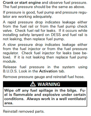

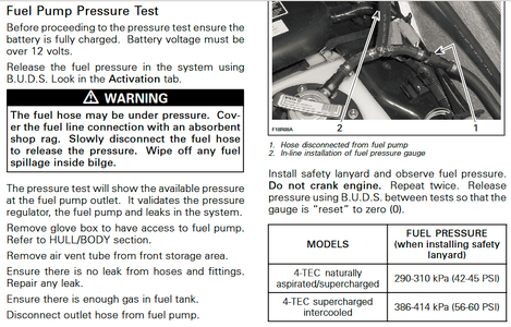

How do you measure the fuel pressure?
What pressure should I see while it is running?, what would a low or high pressure suggest?, and what should be done to rectify?
There is a Tee fitting, I believe with a green cap in the engine compartment on the fuel line before it enters the plastic fuel rail which feeds the fuel injectors.
You do not need to disconnect the line as noted in the instructions if you have a tee.
Make sure there is no chance if the hose blowing off the tee under pressure. Be careful when you go to remove the cap and the hose as it will likely spray fuel unless you have a buds system to release the pressure.
You should download a factory service manual for your PWC The excerpt below is for my 2005 RXT which is probably similar.
