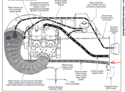

Here is a diagram. The red arrow is where you hook up the hose to supply water to the system. Did you plug the hose and the pipe?
