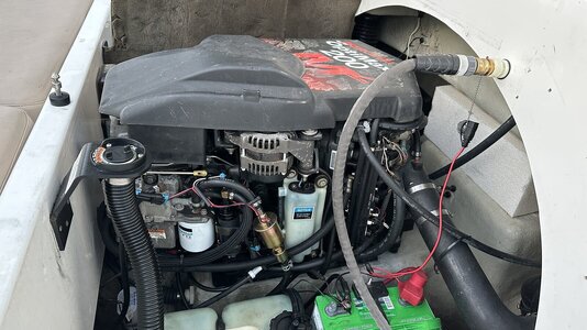

No problems restarting, no beeps... no idea. Took a short video while idling in the water... everything seems fine but does my belt seem loose to you? Belt was replaced two years ago. Haven't dug into things yet, just checking in with the group in case you have a good starting point for me. Boat had plenty of grip/power during launch but I feel like it wasn't getting enough fuel during subsequent acceleration. I've had a couple issues in the last two years but it's the first time for this issue.

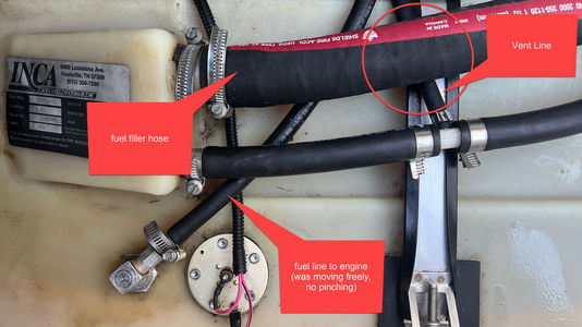

Although I built a deck across the fuel tank to prevent damage, it appears the weight from the ballast bags flexed the plywood and pinched the vent line coming back from the VST. Removed all that and adjusted the vent line position to remove any pressure on it. Once I get it out on the water we'll see if that fixes it. Just in case, I've also changed the fuel filter and will be changing the water separating fuel filter as well (once I find my filter wrench). In the pic you can see the vent line was running underneath the fuel filler hose, and was wedged in between the filler hose and the fuel tank strap. The weight was pushing the filler hose down, pinching the vent hose (in theory). Fingers crossed.

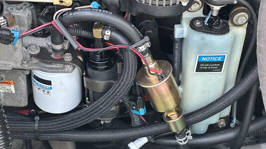

Changed inline fuel filter and water separating filter (with sensor installed this time), and ensured VST to fuel tank vent line was not pinched, but no bueno. Hope was the strategy but didn't work out. Lift pump ($80) and low pressure fuel pump ($120) are on their way from Quantum... I just can't do those Mercury prices... lift pump ($360)/ low pressure pump ($530).

New lift pump and low pressure fuel pumps received from Quantum and installed. It took longer than I expected, there was interference from the TPS and some of those 22yr old fuel lines did not want to come off. Will update again once I get out on the water and retest.
Links to pumps at Quantum Fuel Systems:
Lift pump (link)
Low pressure fuel pump (link)
Pics and video idling post-install (just realized I forgot to "shrink" the shrink tubing around the lift pump electrical connections):
Boat is running perfect again with the new low pressure fuel pump and lift pump. I am sure that the issue was the low pressure fuel pump, but in the interest of time I changed them both at the same time. Our perfect is 25mph @4200, 30mph @4800, 45mph @5500... didn't go for max, prob not much more there, I think max RPM is like 6600 or so.
