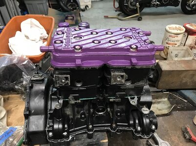

Too bad you guys never live close to me I got a spare everything. LOL The surprising thing is this.... when I have weird problem and change parts even if I do all of them... the ski just laughs at me. LOL When I say replace parts I mean, Complete throttle Body with all 3 sensors, Injectors, Coil, MPEM, Rectifier and I have a spare wiring harness. I have replaced 2 MPEMs as a result and that saved me a whole lot of more time and testing. This last RFI surprised me because it ran crappy below 4k rpm but wouldn't kill and it ran like a raped ape up high. It was the MPEM. I'm going to try to figure out if the problem was the CDI box or the MPEM. I just replaced everything so I need to do some testing. I'm just finishing up a RFI Engine. Not my normal level of pretty but the black was good so LSU'd it. :D
