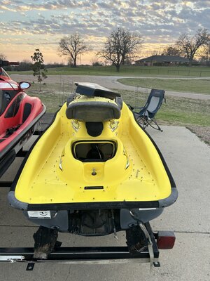

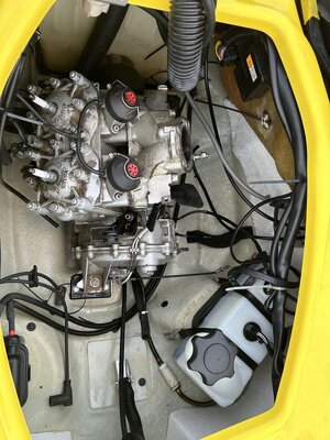

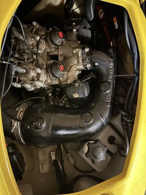

I’ve not been back on this for awhile, but I finally did it all, I mapped all the lines out and im happy to say it’s all hooked up and the engine is completely assembled and back in the ski. But man that was a tough job, I had a lot of blood sweat and tears invested in it, but it’s done now and pretty nice looking because I did a hull clean out while the engine was out. Now I’m just struggling with electrical but I should have it finished soon!
