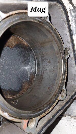

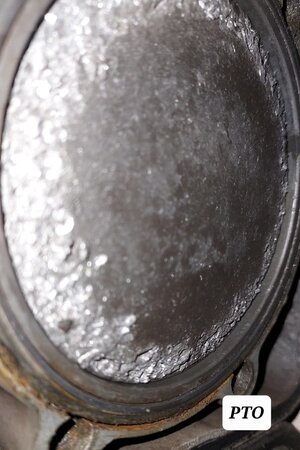

It had 170 compression on both pto and mag cylinders before I put it in the water. After the loud noise, I pulled the rave valves and noticed the pto side rave had chipped.
Spark plug on the mag side was burning perfect, pto side looked a little wet.
I turned the pto by hand without the plugs in, and it turned without much effort. To much back and forth slack though.
When I pulled the head off, this is what I found.

From what you posted you did a very thorough job. Congrats !! Do the checks Popps recomended. Good Luck !!

Looks lean to me.
Looks lean to me.

On one hand I'm telling myself that the plug was a little wet on the pto cylinder, so it was running rich. Cylinder compression was 170 (tested before my 10 minutes run).
On the other hand it possibly ran lean at one point. I corrected it as best I could, but the pitting damage was already done.
I'm not even sure if "pitting" is the correct word. Looks like someone made a bunch of holes with a punch in a perfect circle.
My cousin (very experienced with all engines) tells me that what you are seeing in your case.... at the top of the piston and on the head is aluminum. Supposedly, the cylinder goes lean and the piston gets very hot and turns the aluminum to liquid. That sticks to the top of the head and pulls metal out of the piston. I'm better at looking at pistons to see how they are firing. :) I'm not sure how quickly that kinda damage can take place. Definitely rebuild the carbs.

That damage can easily occur from no oil,,,a broken oil line,,, or faulty oil pump,,,
The pieces in the dome could come from either a ring broken, pieces from the rave valve, a bearing from the wrist pin,,,parts of the piston skirt
It is very important that you find the cause of the failure,,, so it does happen again,,, failed oil pumps and blocked carb micro filters are the usual culprits,,, the pumps are hugely expensive,, so guys go to premix after engine failures.
If you get the cylinders bored, make sure to champher the ports,,,I usually use a dremel tool,,, and make sure you get the proper rave valve to piston clearance,,,(think it is .020),, do this with the jugs on a bench,,, way easier,,,
Mind you,,, now and then on a “tired” motor,,, good old fashioned metal fatigue can be the culprit if there are no other obvious signs.

This didn't necessarily have to happen under your watch. YOu don't know where the engine has been or what happened to it. That kinda damage is not gonna happen without excessive heat. If you'd lost cooling I think the sides of the piston would seize. Hope you get it sorted out.
You lost a lower rod bearing.
You can see the slop in the rod and the scuff marks on the rod. It is also what beat up the piston dome and head.
