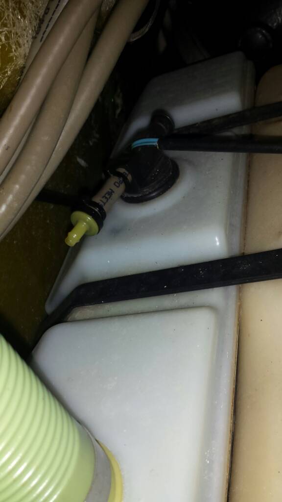

I am going to start tearing into this and seen that there is a small hose with a nipple on the other end as if there should be a hose connected to it...see pic and let me know. Thanks for the help...I know the Tempo lines!!
Ya I think it's a vent also, I have a 98 gti and it has a hose attached leading to the outside of the front of the seadoo, same idea.
Its designed like that no need to do anything to it. Just change tempo lines out and clamps.

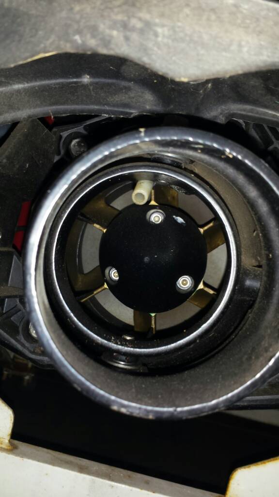

Thanks guys!! What about this little white hose coming out of the jet pump which connects to the siphon bildge...where can I get a new one, there should be two of them connected but one has flew the coop.
Don't run it with only one white tube. The one with the missing tube will pump water into the ski and flood it.
I found that out already...didn't get to much water in the ski before I seen it...I ran the bailer out the back end of the ski, up to the rear seat and just clamped it, and wached the water flow, temporary fix... now it's time fix her correctly..
