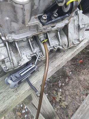

Good morning, I'm in the process of a swap 951 motor. Going from a GSX limited (1998) to a GTX limited (1999) should I do anything for the bottom end oil that's in there ? Or just leave it alone ? Thank you again. Love this forum. It's been great thus far
Balancer shaft oil? Yes, change it out. It is a maintenance item.
There is no crankcase oil.
Good morning, just curious. So it's a 951 motor. This one's from a 98 GSXL. I'm seeing different oil recommendations. Should I use sae 30 or the 2 stroke oil. I do know it's 40ml thanks again my guy. You been helpful for sure with the swap.
Good afternoon, so looking at the front of the motor (oil pump side). The hex on top of the bottom end. I took out that bolt damn near flipped the motor. No oil is coming out. Definitely supposed to be oil in there correct?
