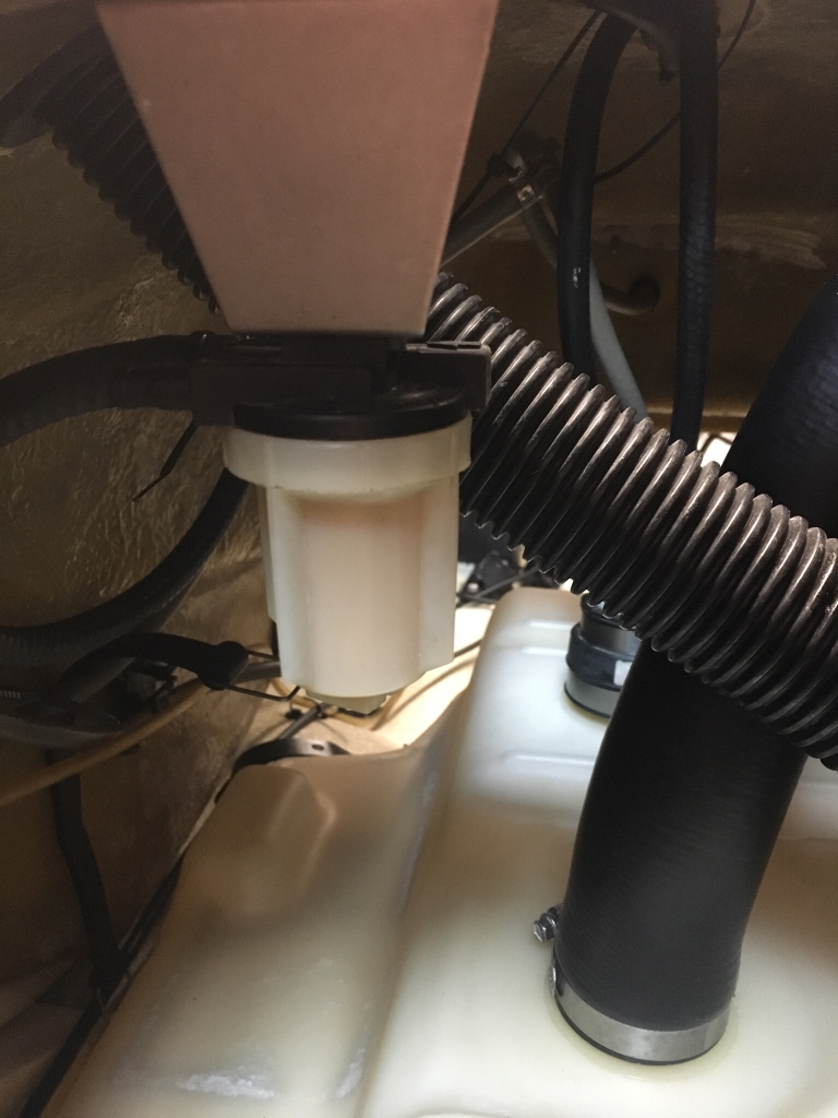

I do have another question though as it seems your setup is the same. I notice the oil tank has 2 fitting and was curious if something should be on this other end. I have bought this ski not running and have been replacing and fixing everything on it as my first ski. The fitting on the right is the only one that had a hose attached

No, that is a check valve to let air into the tank but not oil out. Your's is correct.
