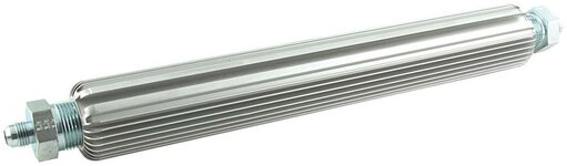

TANK-CT1L8B-L.jpgTANK-CT1L6B-SIDE-L.jpg1ltr anodized
31b5l6Eco3L.jpgL X W TBD
Can be cut to length
BTR-12JF-L.jpgDW-BTR-12JF.jpgMeh, maybe?
Order of placement within oil circuit TBD after lab bench studies.
All fitting will be 8AN with the option of changing to lessor to accommodate a smaller dia hose if warranted. (static line pressure considered)
All this to knock tank temps down as much as possible w/o compromising too much "real-estate"(?)
